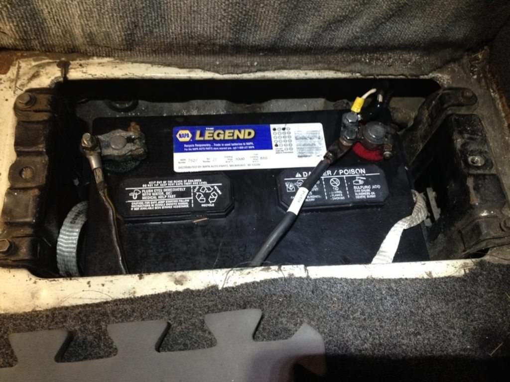

Re: Basic Van knowledge for new owners
PNW vanwagon
I just did this: group 27 was perfect fit. You'll need to fashion a new strap down for bigger battery
I have had good luck with this battery as well.
Napa Legend #7527 Group: 27
1000 cranking amps
810 cold cranking amps
You will need some nylon straps to lower it in/pull it out of the battery bay.
Attachment 7187
