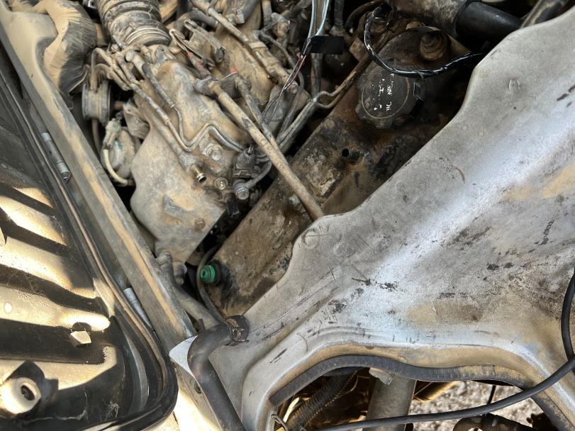

Any idea what this green object might be on my 1988 Toyota Van LE?
Attachment 11404
Looks like a broken PCV valve, of the (incorrect) plastic variety.

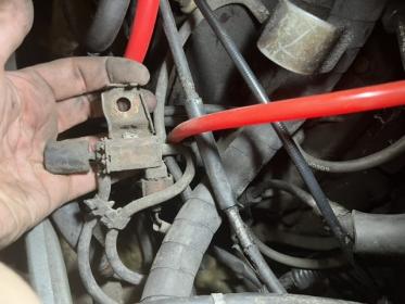

This valve/actuator was dangling to the back of my engine, does anyone know sure where it should be mounted?
The vacuum hoses are so long, I have no idea where to look.
I think it is valve nr 2 on the diagram
in my repair manual, i think it is mentioned as a vacuum switching valve, it is listed as part of the air conditioning system, but it does not mention where the part is supposed to be mounted.
Attachment 11700
Attachment 11701
There's a hole on the side of the engine block behind the oil filter. Here's a picture of one mounted:
https://hosting.photobucket.com/imag...MG_4477(1).JPG
It's your "pressure up" vsv. One hose should connect to the manifold via a little black filter device and the other hose should go to your fuel pressure regulator (other side rear of engine). Tim
Thanks a bunch!
I put it back where it belongs. Judging by the amount of grime and rust covering that hole, it had not been there for a long long time.
