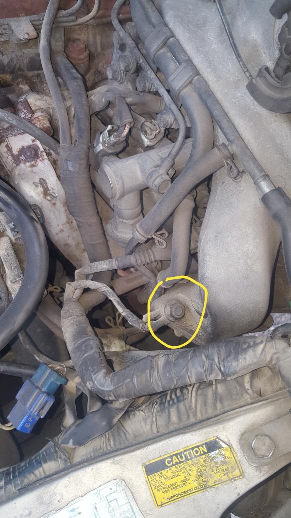

One thing I neglected to take a photo of is the engine ground strap, so I do not remember where that goes exactly. Right now it is hooked up to the driver side engine mount but there is a possibility it is not getting enough contact. Does anybody have a photo of where the engine ground strap is supposed to go? This is the closest photo I could find but the end of the wire disappears into darkness.
https://www.toyotavantech.com/forum/...ull=1#post5171
Re: Fresh rebuilt engine swap, idle/timing problems
The end of the second leg of the battery ground cable does go under a bolt on the engine side of the driver side engine mount. There is also a harness ground strap that should be attached to the forward intake stud where the two halves of the intake attach.

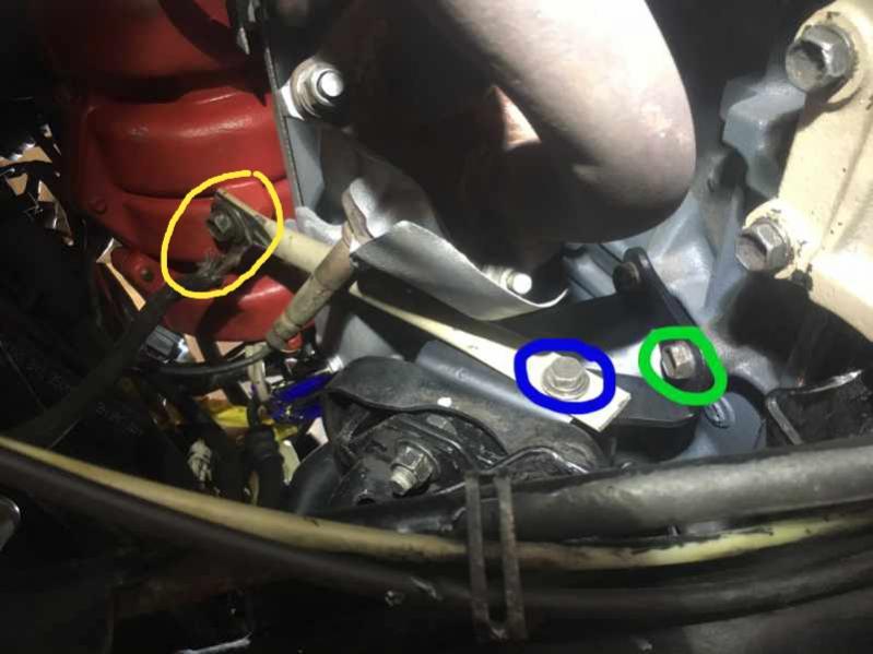

As an experiment I attached the ground strap to a different spot (in the photo) after removing paint on the bar with some sandpaper and when test running the engine it made a difference. The idle speed dropped and I no longer had to crank the distributor cap all the way to the left in order to get the timing in the ballpark. Engine was difficult to start at first but now idles less unevenly and also does not die right away so obviously the ground is an issue.
I want to make sure I put the ground in the right spot. Initially I put it on the Green Circle bolt because that seemed to line up with the way the wire was naturally bending. It sounds like from the post above it should be on the Blue Circle bolt. Wondering if I put that Blue bolt in backwards and it should be sticking out from the bracket so that I can put on the intake manifold support, ground wire, and then a nut on top.

Yes, the green circle is where both of mine have the engine side of the ground cable attached. Be sure your negative battery cable goes from the battery to the chassis and then on to the engine and that all connections are clean. That means sanding your colorful paint job to clean metal unfortunately.
If what I circled in yellow is the end of your cable you should probably be looking at a new cable. It may just be the focus of the pic in that area but that looks a little frayed and exposed. I'm in the middle of doing the same on one of my vans.

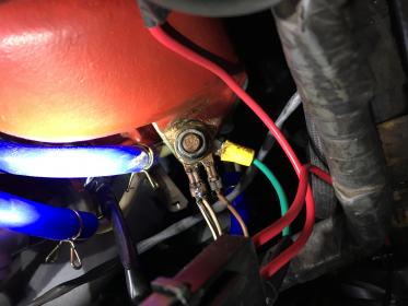

Back to square one. Idle uneven, cranking the distributor cap to max, and throwing code 6 (RPM signal) and 10 (Starter signal) again. I think it might be the ground in this picture which I cleaned up at the same time I replaced new battery-to-engine ground, but will mess with it tomorrow and see if I can run a new wire to wherever it goes. I tried to put some solder in the connections but they were too full of oil and grease for it to stick.
