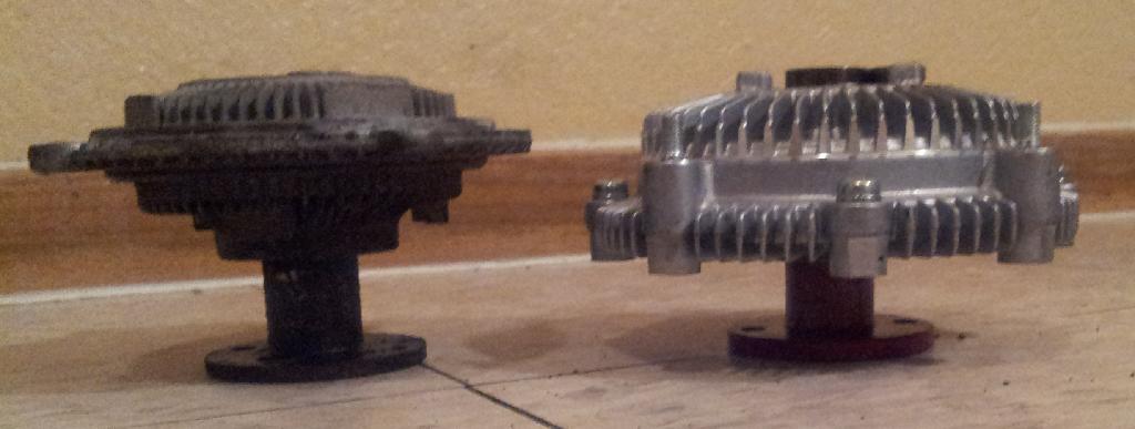

Changing the fan clutch turned out to be pretty easy once I removed the passenger seat and moved the engine panel out of the way. The only complication was that the old aftermarket one used 4 SAE bolts to hold the fan in place but the new OEM one had 6mm studs. I had to pick up some nuts at an auto parts store.
The Toyota one is significantly heavier, not sure if that's a good for MPG but my engine temp is now at around 11:00 on the gauge instead of 12:00 like it always had been before and no hint of overheating.

Curious on how that Toyota fan clutch is working out, last summer my van was running hot enough to constantly have me checking the temp on the dash. I notice my van has an aftermarket fan clutch and was wanting to go OEM, you pleased with your purchase?
Re: Overheating after some unrelated(?!) repairs
So far the OEM fan clutch is great. The gauge hasn't gone past the mid-point since I put it in, and I've definitely been putting it to the test.
The old clutch was the same for at least 2 years though - at some point it just stopped working properly. Tim put up some videos on how to test them - I'd recommend giving those a shot to see if that is in fact your problem before spending $100.
