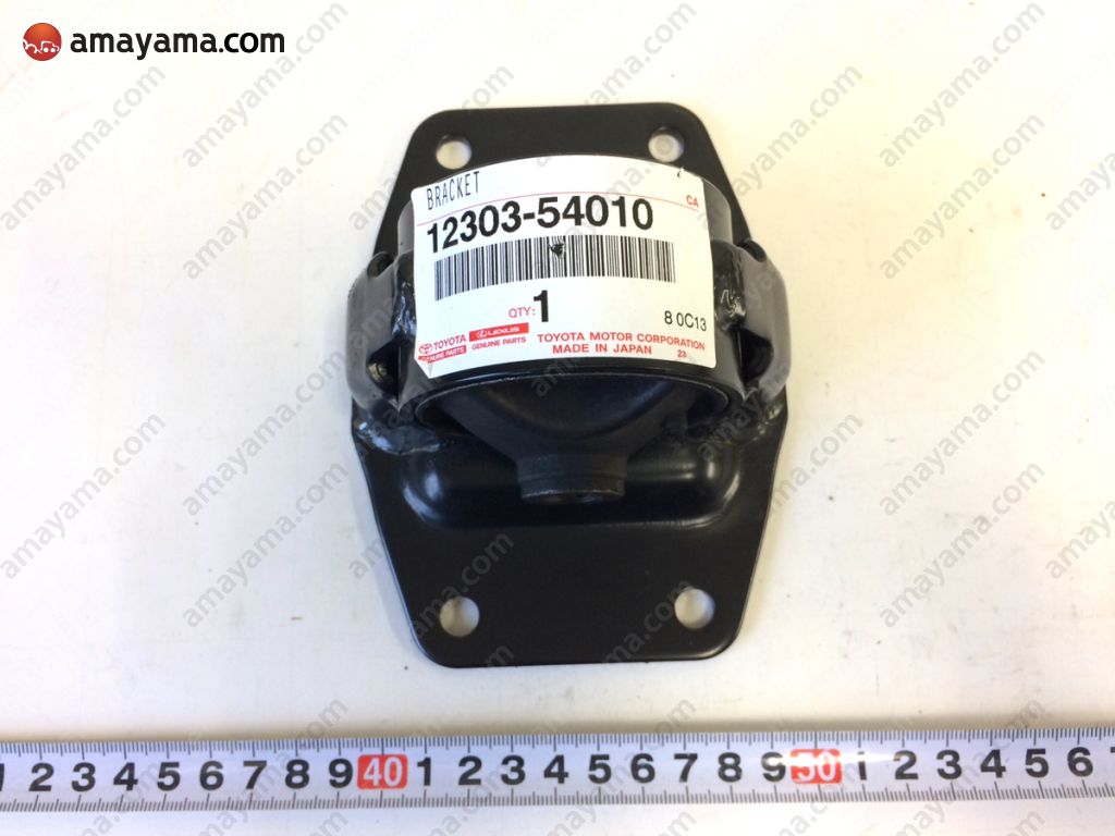

I also just went down the rabbit hole trying to find that rear mount for my 1987 4wd auto. As posted above the part I was looking for was...12303-54010
http://i8.photobucket.com/albums/a23...untauto4wd.jpg
per the information in previous posts on this thread I found this westar part still available in canada but for over $100 (CAD but still). https://www.thewrenchmonkey.ca/produ...westar/em5749/
Also found several places where I could get the Febest Rear Engine Mount Febest TM-101 Oem 12303-54041 for a lot cheaper. https://shop.febest.eu/rear-engine-mount-tm-101.html
A HUGE thanks to those who posted these alternatives because I had spent hours searching for options. I'll post again once its installed to again confirm still the right part.

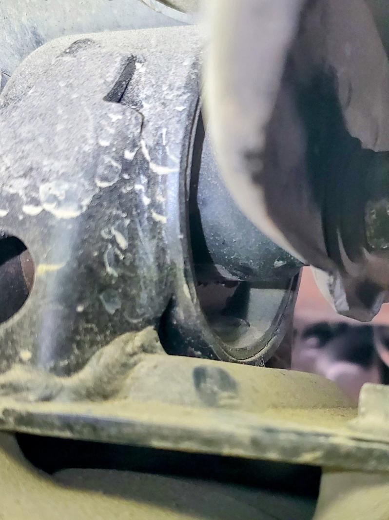

Well, barely a year and 4000km since the Febest TM-101 was installed and it looks like it's busted already :doh:
Attachment 12232
Re: motor & transmission mounts
How would you know from that view? I got out my Febest mount to double check this and I'm not convinced yours is broken. The Febest mount is only vulcanized at the 2 - 3 o'clock and then at the 9 - 10 o'clock positions. The rubber material has no attachment/bond at the bottom of the circle. Yes, my new mount does have rubber touching the bottom of the circle, but it's not bonded/attached. It appears to me that yours may only be flexed due to the load (could be normal). Are you experiencing banging or shifting under acceleration? Tim
Hmm I hope you're right. I've been hearing a clunk sometimes when releasing the clutch shifting from first to second and second to third when going up steeper hills.
I was going off the best side view photo of the mount I could find online where it looks like the bottom part is attached, but you're saying it's meant to separate under the weight?
I'll try and get a better photo of mine later.
