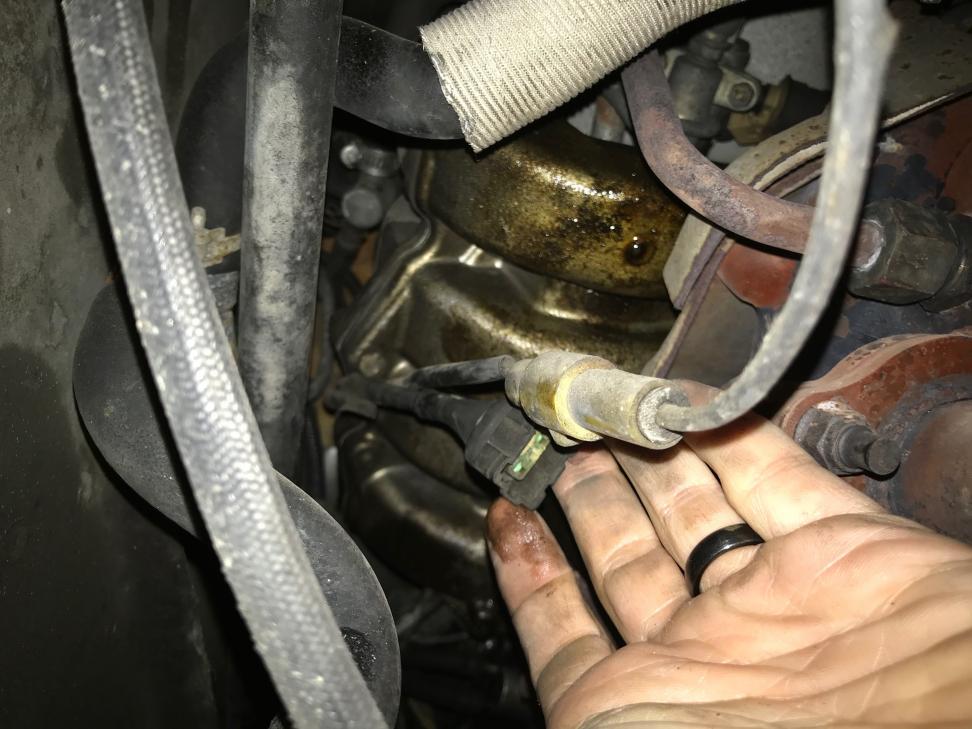

I'm assuming this one is California's fault, but I couldn't find it in this thread or any others google gave me:
Attachment 8933
to help triangulate - that's between the airbox, battery, and exhaust, runs up and taped to the O2 sensor wire.
That's your Throttle Position Sensor harness connection. On the back side of the throttle body there's a black plastic box. The connector in your picture should be plugged into that.
Here's a thread that features the throttle body and the TPS:
https://www.toyotavantech.com/forum/...-Throttle-Body
Thanks Tim, I never would have caught that the way it was taped so far down to the sensor wires. I’m wondering if that was responsible for the way she’s always bogging down after puddles.

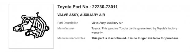

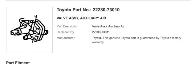

OK - here's one I could use some help with compatibility on ... I'm looking for part #22230-73011 Auxiliary Air Valve which is NLA. (For '85-'88)
HOWEVER - the part #22230-73010 Auxiliary Air Valve for an '84-'86 is possibly available (and also one that I can probably go get from a junkyard)
It says that #22230-73010 has been REPLACED by #22230-73011... Does this mean I can use 73010 in 73011 applications? My concern is the 2.0 Vs 2.2 L engines, but maybe it's pretty much just the same valve? I don't really want to pull my manifold if it won't fit :)
Attachment 9034
Attachment 9035
Links if that his helpful:
73010: https://www.toyotapartsdeal.com/oem/...0=YR22LG-MDEA)
73011: https://www.toyotapartsdeal.com/oem/...230-73011.html
If one replaces the other then I'd have to say either one would work. I have been looking for one of these for a while with zero success. At one time there were at least 2 or 3 aftermarket manufacturers that made these, but none of those are out there any more either. If you find a source, please post as I'd be willing to pay up to $300 for a new one. Tim
I believe Nissan makes it. There are many version but all look the same. Just make sure the mount is like ours. Rock Auto has some of these you may want to check out
I don't think Rock Auto has these (at least not one made to fit the van). They used to, but now under that title they only show Idle-up Diaphragms. If anybody finds one that is compatible and will interchange (without reinventing the wheel), please post a link. Thank you. Tim
