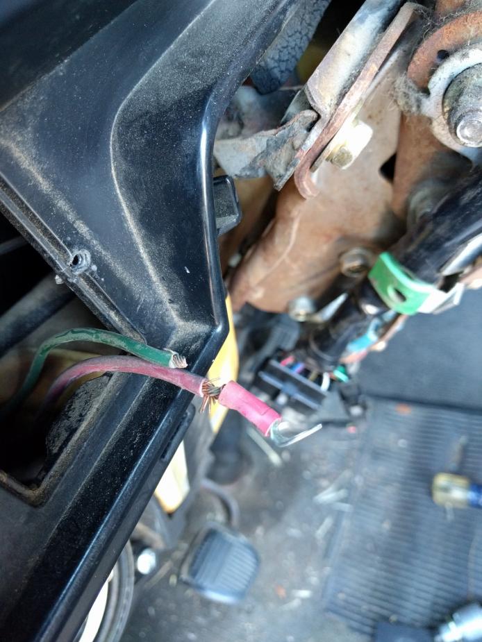

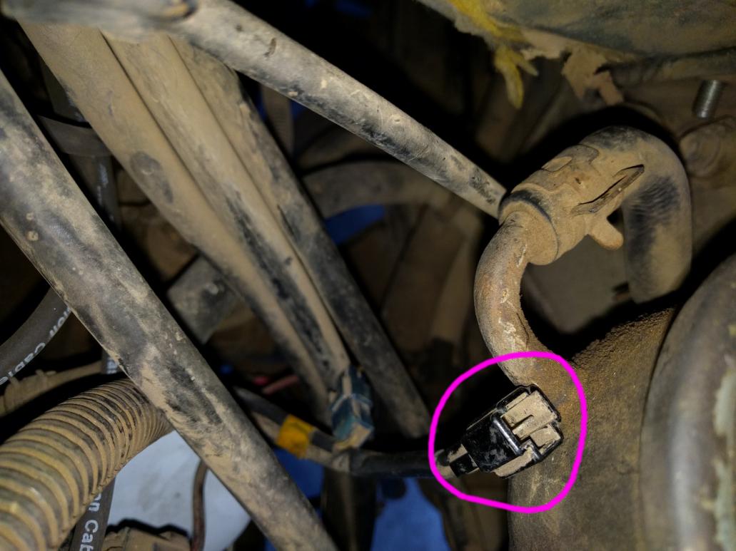

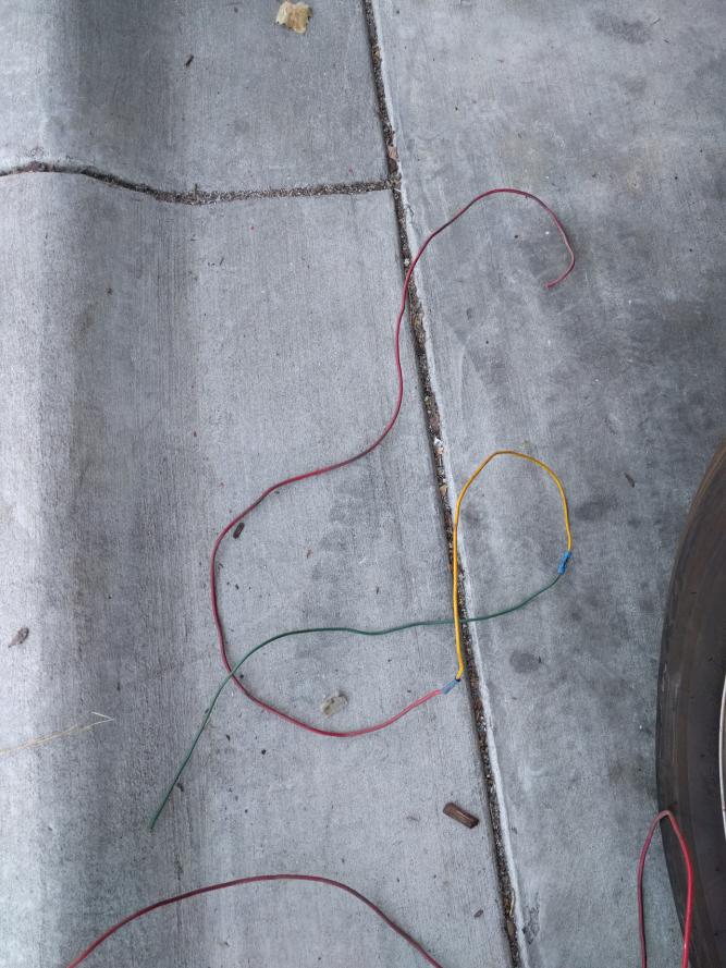

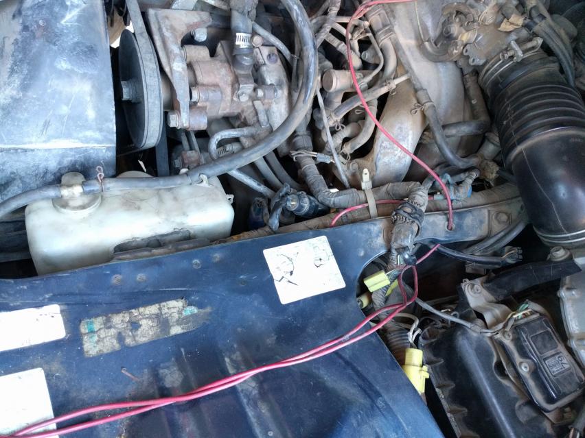

    So happy I got to rip out this starter bypass hackjob today!!! Having to push in a finnicky high current switch every time I started the van was getting old. Tim's lengthy post in this thread was very helpful.

    I had to make up a wire that goes from the harness to the small signalling connector on the starter. I am not too satisfied with using disconnects/spade connectors like I did though. Feels kind of flimsy. Does anyone know where I can get the male end of these connectors? Pick n pull my only option? This is probably an obvious answer but some quick web searching and a trip to the auto parts store didn't yield anything. I have circled said connector in the photo. Thanks!
