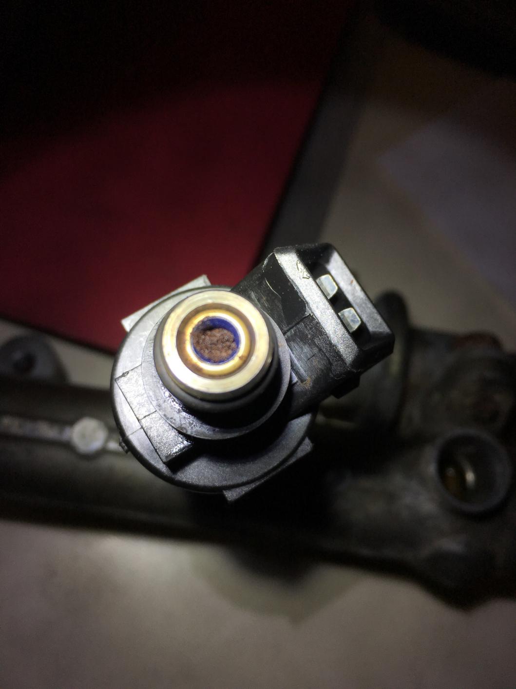

    Looks like the mystery has been found with the fuel.
    You may all want to do this.
    The van was stored for 25 years. The owner was very careful when storing.
    Loading up oil and fluids. Draining fuel tank, cleaning and then preserving the inside with some kind of preservative product. He was an engineer for Pratt and Whitney .
    All fuel lines were drain and blown out with compressor.
    After engine rebuild 6 months ago cylinder 3 went bad.
    They said inject 3 bad. Replaced all injectors. Ran for 15 minutes and went bad again. Only this time cylinder was always wet (fuel). After looking at everything and testing everything include all the suggestions here, there was no conclusion. Then when he took the injectors out for the 4th time he saw this. The one half way covered is#4 and the one fully covered is #3.
    Rust city. From where???? New filter installed after engine rebuild. Why only 3 and 4?
    Turns out that the fuel pressure regulator is positioned just in front of injector feeding pipe and filter. Took regulator out and it was dirty with rust. Cut it in half and it all just poured out. This was the one area that did not get drained or blown. The rust went into the pipe an hits 4 first then 3. # three was so loaded with rust it stayed open causing it to be wet.
    4 still got some but not enough to screw things up. 1 and 2 had none. I had a new regulator. It is all being finished today after they re-blew the lines clean again with the 4th intake manifold gasket.
    Should pick up by tomorrow.
    I will tell all of you how it runs when I get it.

    Yes, your pics (above) are a very familiar sight to me. Diagnosing was a bit strange/troublesome, but without hands-on things can be hard to figure out. For some reason it's always #3 that gets plugged up 1st. For you (or anyone with this problem) I would highly recommend replacing the factory fuel filter with one like I put on. It's been covered in detail HERE. FWIW, with the factory filter mine was clogging #3 injector every 5k miles. After the filter mod I installed a pressure gauge to verify pressure/flow and I thought it would give me an indication of when the filter was beginning to clog. With the new filter, pressure remained constant and van ran good for 50k miles. Unfortunately #3 injector did eventually clog again (@50k miles), but considering it made it 10X longer, I considered it a success.
    I think it's also possible I could have avoided (or at least prolonged) this issue had I changed filter elements on a more regular basis. Since the last episode I've begun replacing that filter element every 10k miles, but it's only been about 15k miles since then, so it will be at least 2 years before I hit the 50k mark again. Good luck. Tim
    PS: As you can see in that thread (linked to previously in this post) the tank was cleaned thoroughly. The 1st clogging after that cleaning I attributed to rogue particles left over in the tank. After the next 3 episodes I started thinking there to be a hard caked-on residue inside my fuel lines. Each few hundred miles of constant flow likely dissolves and releases more particles into the system. On mine there is still ~3 feet of old steel line after the filter, and that could account for the last clogging of #3. Eventually I'm hoping this will clear itself up, but so far it's still been an issue (although much less after the filter mod). Tim
