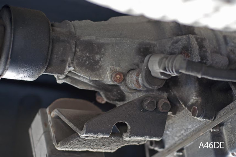

    Then I located the speedometer gear. It is on the right side of the transmission's extension housing. The sensor on the left side is a secondary sensor, don't touch it!
    There is a rubber boot protecting the wire connector. I moved it out of the way in order to disconnect it easier. Then I removed that rusty 12mm bolt that holds the little retention plate in place. The bolt was actually seized and took some good muscle to get it off (I retapped the bolt hole later on as I reassembled everything).
    The whole assembly actually didn't want to come out. The rubber o'ring has essentially "glued" itself into the aluminium case over the past 18 years. I had to get some large pliers to twist it a bit in order to break it free. Then it slid right out.
