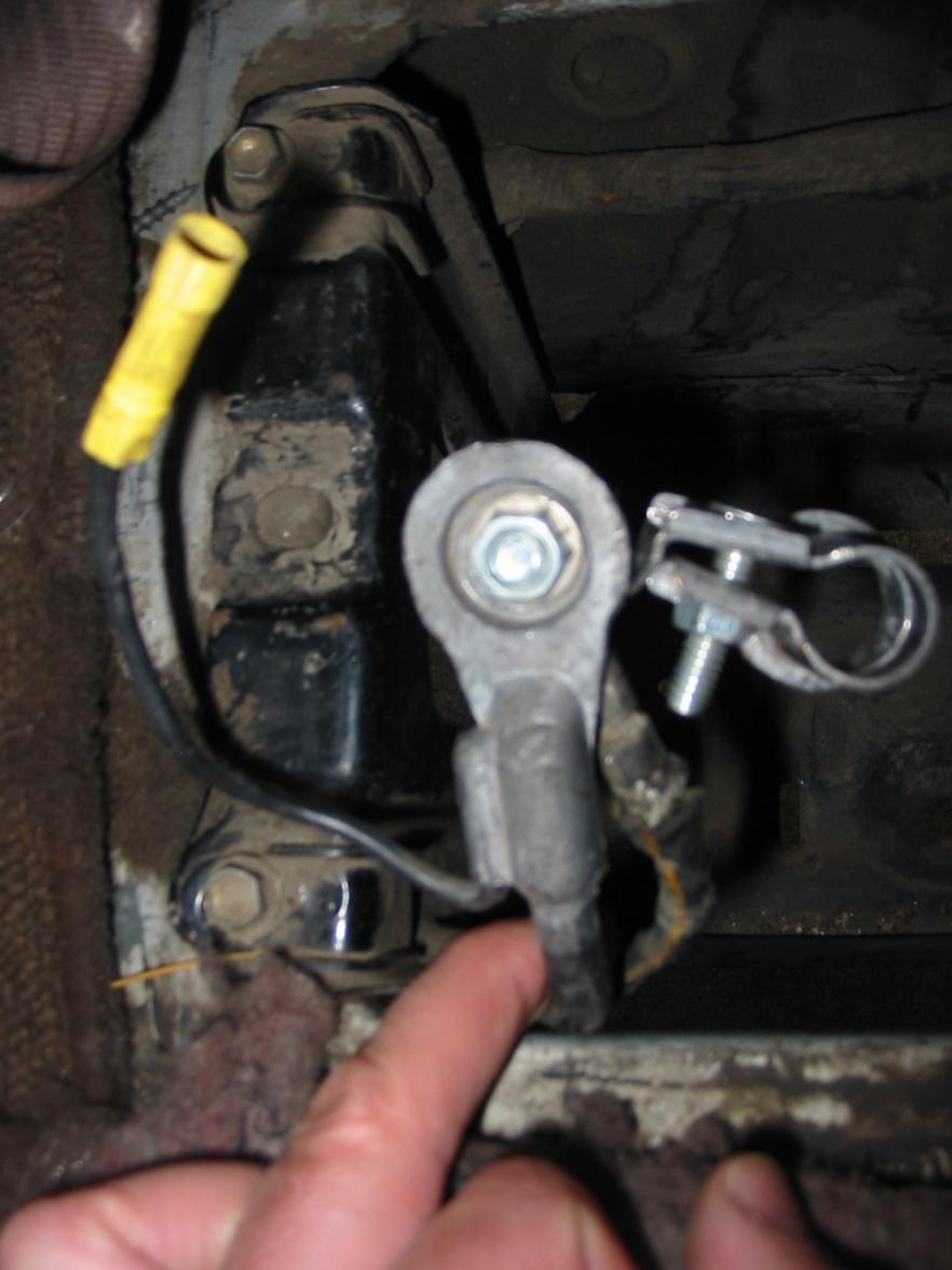

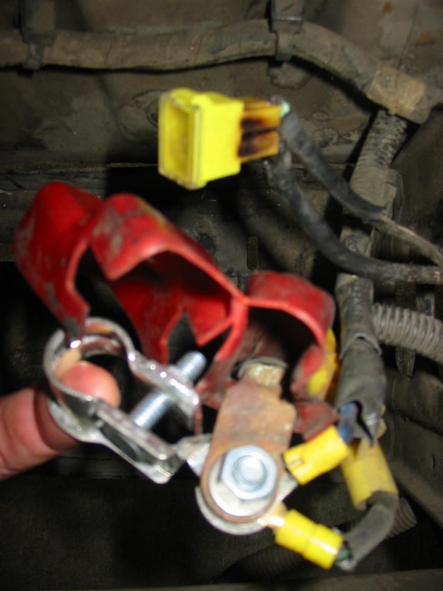

    OK guys, here's a few pics to show you what I'm dealing with.
    Negative battery terminal:
    What's supposed to be attached to the empty yellow crimp?
    Here's the positive side. Hmmm.
    Up top, the yellow box, is that a fusible link? Could that be the FL1.25B? On the clear plastic cover it says 60A 32V. (I don't see anything underneath the battery tray, fyi) Also, note the discoloration of the yellow plastic. From heat, obviously, but why/how?
    The FL 0.5G is there and seems to be in good shape.
    But what I don't see, unless I'm mistaken, is the FL 2.0L. Could that be the problem, right there?
    Administrator timsrv's Avatar
    Lots of them
    SW WA ST
    5,854
    Re: Battery charged, van won't start
    Somebody's been messing around with this. I'm okay with alternate methods to get the job done, but correct gauge wire & fuse values need to be adhered to. Cheesy connectors & crimps have no place in this area. Anything that looks burnt or corroded is also bad.
    Use the fusible link thread to determine correct wire & fuse sizes, then repair as required. If you don't have the tools to make solid crimps & connections, then you'll need to find somebody who does. Have fun & good luck. Tim
