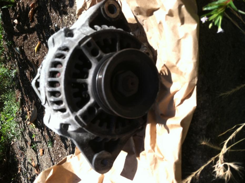

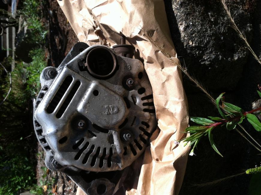

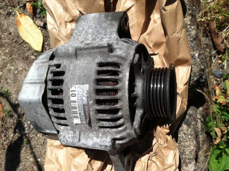

    I kept the JDM alternator to have it rebuilt after I research some reputable shops, in the mean time here's some pics-
    ENJOY!!!
