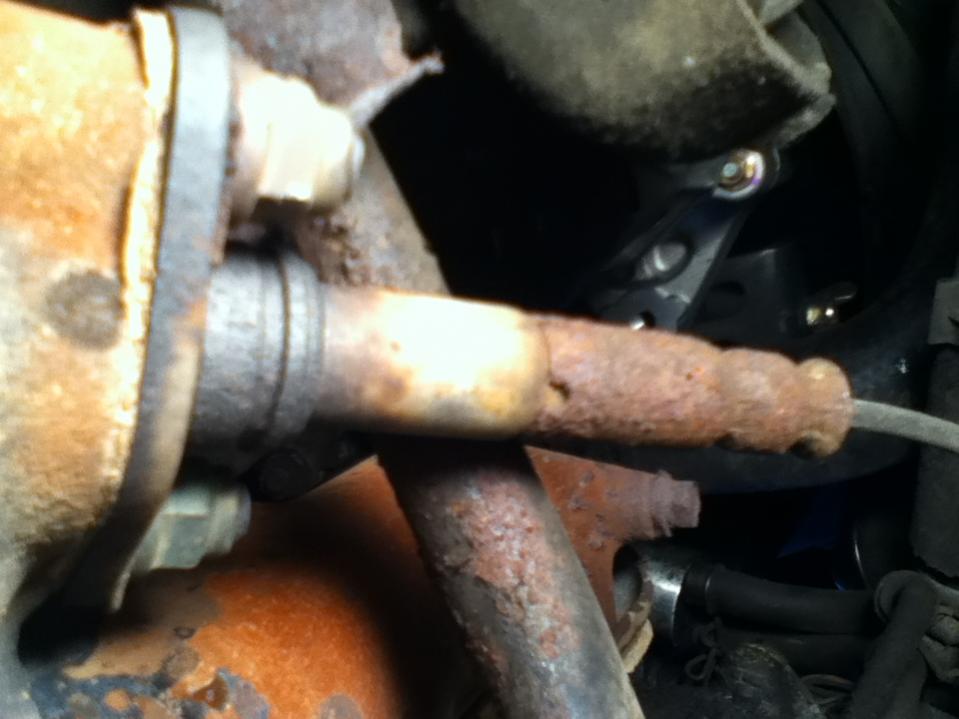

    i was looking around for corroded wires or other things that may be causing trouble and i found this connector but i have no idea what it it. it on the front right corner of the engine block. it was very rusty and loose. i sanded it and it seems to stay on better. the pic is blurry... you can see the belts in the background (also blurry). the orange circle that the paddle connetor comes out of (on the engine) is rusty!
    i was trying to put a new positive battery cable on but i couldnt get at it. it was one wrench size i couldnt find and theres no way a socket would reach in there. i was going to put on a new rotor and cap but wanted to check if this little connection was what was giving me trouble. the van seems to be starting better but it still needs the TPS which havent put in yet... i forgot to get a gasket for the throttle body. hopefully i can find one today.

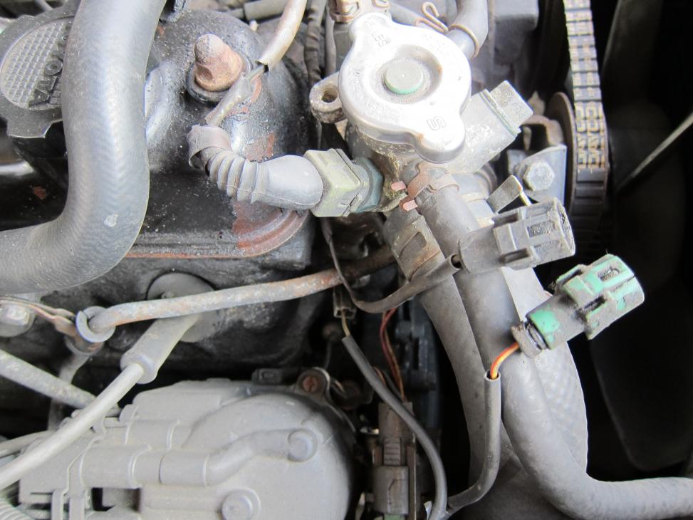

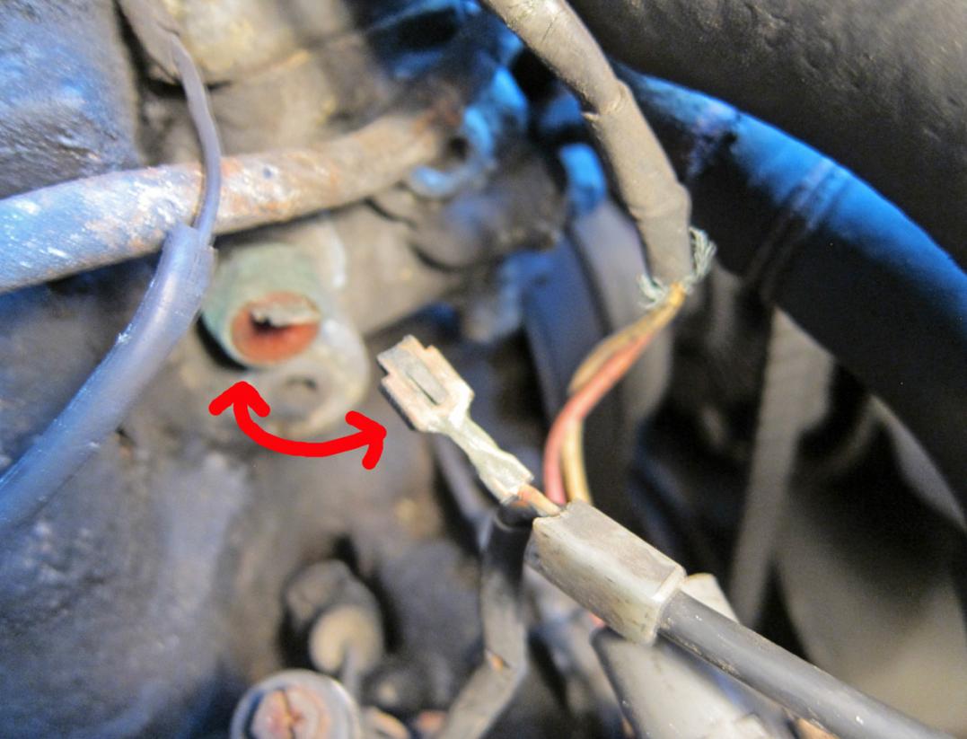

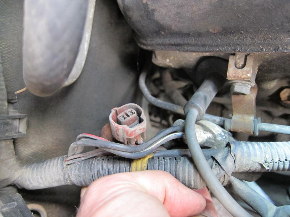

    i also came across some connectors that were not connected to anything. they did have caps on them like some of the testing ones do but some or all may be for testing. all 4 were on the right (passenger) side of the engine. anyone know what they are?

    in the pic with the 2 connectors...... i pulled them out to take the photo but they were hanging way down and were not visibly obvious at first.
