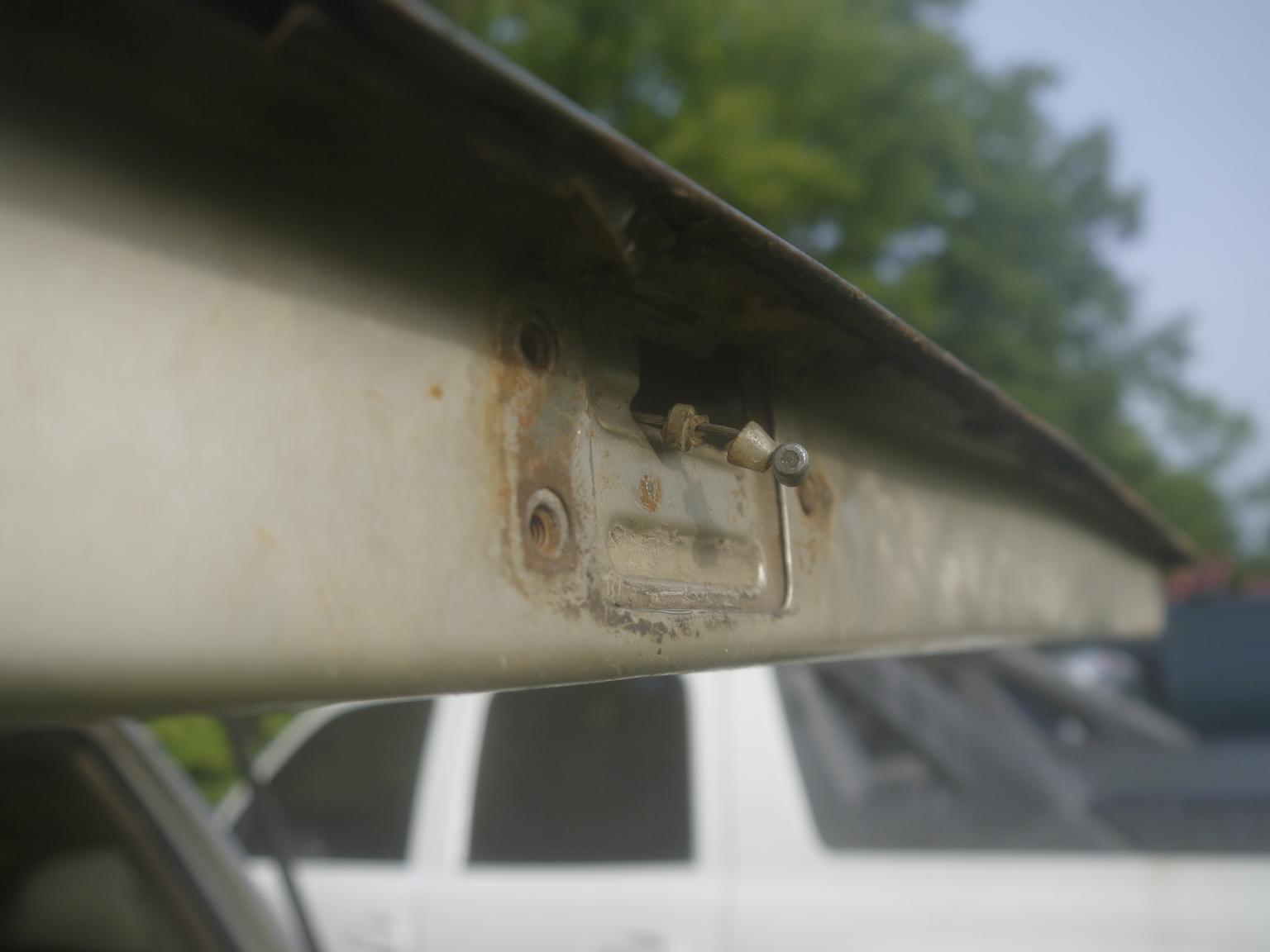

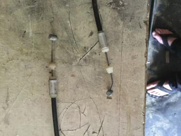

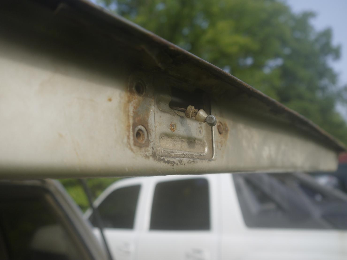

Currently my tailgate is held closed by removing the trim and ratchet strapping the gate to a fixed point inside the van.
Obviously I'd like a somewhat more functional tailgate, but the cable surround which anchors it to the fixed part of the latch is broken.
Any ideas on how this can be replaced or fixed?
I'm also down to 1 of the 3 original bolts holding the lock onto the gate body, but I'm struggling to find similar bolts anywhere.

Have you tried pulling it out ( take a lot of pictures) and looking at exactly how it works? Then you can figure out exactly what parts you would need from a donor van. Seems like you can't make it any worse if it is already broken.

The 2 broken white plastic pieces are supposed to be part of the cable sleeve and they clip into a fixed point so the cable has something to pull against.

It's hard to tell from your pictures and description what exactly is broken on your van, but I replaced the rod that connects the exterior handle to the latch with an appropriately shaped and trimmed coat hanger. Took some experimenting and some gently bending, but worked well. Also, I snagged a bunch of the little white plastic retainers that hold the rods in place from a junkyard years ago. Worth doing for sure (grab the bolts while you're there!), as our old vans more often than not need their locks and latches (and everything else for that matter) lubed for proper function, and digging into the doors can easily result in a broken retainer. Typically, though, they're not that hard to make work with a little time, effort, and grease.
Oh, and worth noting, don't forget to re-apply silicone to the plastic vapor barrier. Makes a bigger difference than one might think in terms of comfort and noise.
Good luck!

Didn’t see a solution to this broken part in the thread. It’s the cable that connects the handle mechanism to the latch. Think a bike shop could fabricate one of these?

Try the PicknPull in SLC, UT. they’re still showing a van in the inventory. Call and double check before heading out there-
https://www.picknpull.com/vehicle_de...YR28VXJ5064099
Good luck!!
