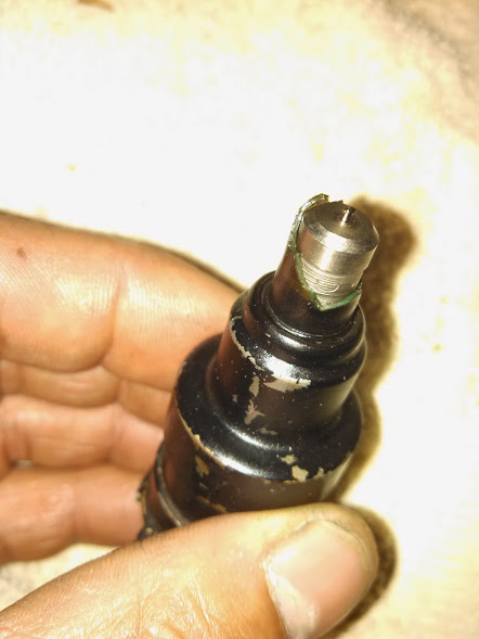

    So I am a dumbass and dropped and dropped this injector while installing it.
    If it was one that went into the cylinder, i would replace it with out a doubt.
    I checked spray pattern. And it loos like all the rest.
    My question is what is the purpose of the protective coating???
    I think there is enough of it left that it will still seal and not create a vacuum leak.
    I don't see possibility of a fire.
    Anyone else think its usable?
    I cant be the first one to have done this.
    There are no vans near me in junk yards. What other cars can i get an injector from????
    Thanks!!!!

    That part is called a pintle cap and it's easily replaced (by somebody with the right parts and tools). Any time you have your injectors out it's just a good idea to take them to an injector shop for servicing. I'm not sure about Reno, but here we have Dr. Injector. Their service costs $20 per injector. For that they will test and document patterns, flow rates, and leak test. Next they ultrasonically clean them, retest, & document. Assuming they pass, they will also replace the pintle caps, o-rings, and insulators. If you don't have a Dr Injector locally you can always send them by mail (funny because I just sent a set to him this morning). He will work his magic, then call for credit card info, then send them back. Here's a link to a thread where this is discussed: http://www.toyotavantech.com/forum/s...=4824#post4824. Tim

    When I had my injectors serviced, one of them came back with that tip broken. I installed the injector anyway and it's never been an issue for the next 35,000 miles.

    I guess not all injector service places are as thorough as Dr Injector. The one in Gladstone OR has always put new pintle caps on my injectors as part of the $20 (each) service. Tim

    Hey coronan On this model of injector the pintel cap protects the tip of the injector and helps retain the lower seal between the injector and manifold. Dont worry about not having the metail filters. I do well over a thousand injectors a year and never have a issue with the newer style filter.
    Tell you what. Send me your injectors and I will perform a free cleaning on them and return them with new filters seals and pintel caps.
