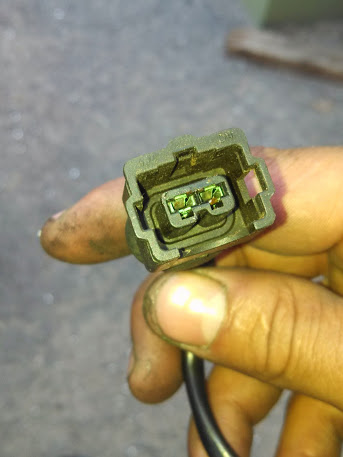

    I stumbled across our square 2 pin connectors. You know the ones that are brittle and always crumbling on us.
    My goal is to find ones fresher than 30 years old that will not have me in the same situation.
    Mitsubishi's seem to be a good source and are easy to pull as they are right on top. P&P wants about $4 ea.

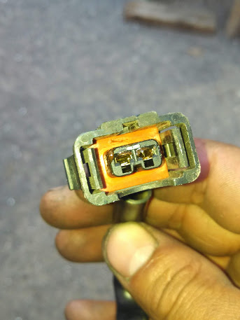

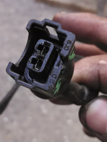

    Early 90 Mitsubishi Eclips, and Galant yeild these connectors on the injectors and VSVs.

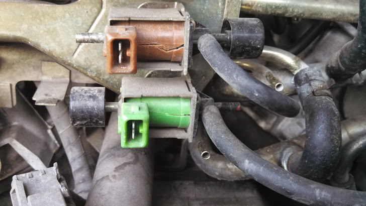

    It was tempting to take these VSVs

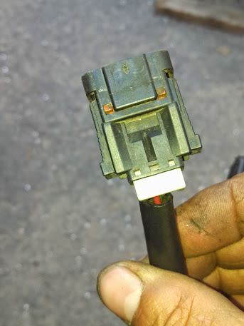

    Also Late 90's changed to a connector with out the metal clip. (I personally have a thorn in my side about those.)
Size:  34.2 KBName:  IMG_20140813_130340_741.jpg
    Squeeze to release. But it plugs in the same.
    It is a large connector and may not work in certain areas on the van like the injectors. But I would we stoked to phase these in to my van.
    I already put one on the temp sensor on the radiator cap.
