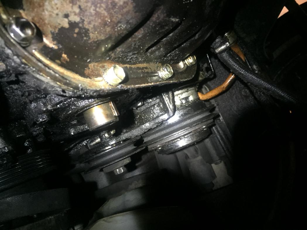

    okay i got the pulleys loosened and removed the belts, replaced the seal and got everything back together, i think the pulleys are okay. I used a strap instead of a chain wrench because its what i had, seemed to work okay but the right tool would have been better. one thing im worried about is that maybe i pressed the seal in too deep? is that possible... not sure but it seems a but deeper than the original hopefully it all works out. my oil leak is gone and 20 years of oil sludge from someone letting this leak for far to long, are now clean. what do you guys think , too deep?Name:  IMG_5809 2.jpg
