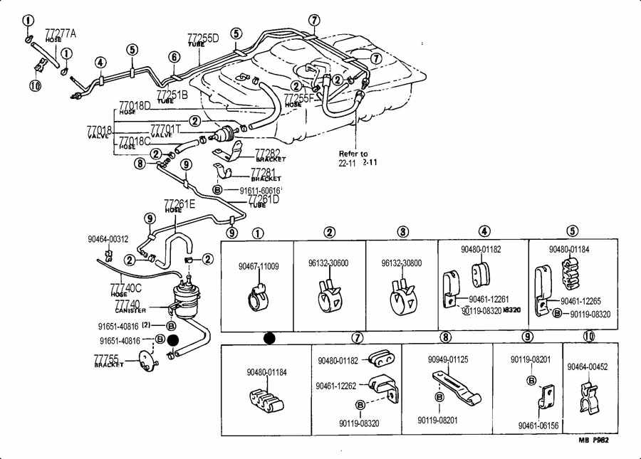

    Since my injectors and fuel tank were pretty nasty, i am also trying to clean out my fuel lines. There are two lines leading from the fuel pump. One has a section of rubber hose attached to the metal line. The nuts holding this section are stripped. Does anyone know if that hose section is necessary? I was going to hacksaw that portion out and replace it with bulk hose after i clean the line out. Also, why are there two lines from the pump and which is the one providing fuel to the injectors? In the diagram it is the hose labeled "refer to 22-11"Name:  MBP982.jpg

    The bigger of the 2 lines is the pressure line from the pump to the engine. The smaller one is the return line. Both have fuel flowing through them. The pressure line goes from the pump to the filter, then from it to the fuel rail. At the back of the fuel rail there is a pressure regulator. The regulator only lets fuel past it when pressure in the rail hits ~40 psi. The fuel that gets past the regulator returns to the tank via the smaller line.
    I've been through these type of fuel system problems myself. For some reason it's always #3 injector that gets clogged up 1st. In case you haven't already found it here's a thread where remedies are discussed: http://www.toyotavantech.com/forum/s...ge-not-working (contamination discussions start on page 2). Tim

    ok, thanks. i'm pretty sure the problem came from the van sitting for so long. Ive basically replaced or cleaned out the whole fuel system. Last part is the line running from the tank to the filter. Just gonna leave that in place and fill it with sea foam or vinegar, block the end and let it sit, then flush it out. The tank was full of corrosion and the pump was nasty with a hole in the filter.
    Those nuts on that one section arent coming loose so ill just cut it out with a hacksaw and hope its just a connector and not a valve hidden in there or something.
    But thanks for the clarification on which line was which. I couldnt trace it with the tank in place and I definitely dont want to drop the fuel tank again unless absolutely necessary
    Re: Fuel injector replacement
    On that smaller line, due to lower pressures, you'll find they use standard fuel line with hose clamps. In contrast, the pressure side uses special threaded fittings and hoses (due to the higher pressures). On my van that's featured in the thread (linked to above), that smaller steel line on the fuel pump bracket was plugged up solid. I cleared it using a ridged wire, some drill bits, air pressure, and carb cleaner.
    Dropping the tank isn't that big of a deal. If there's an access issue, I wouldn't hesitate in doing so. Once the tank is empty, barring corrosion complications, it can be dropped in as little as 15 minutes. Tim

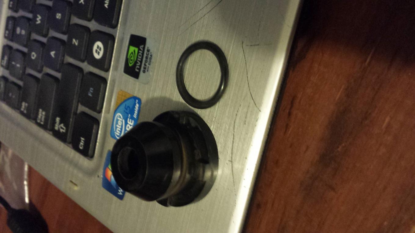

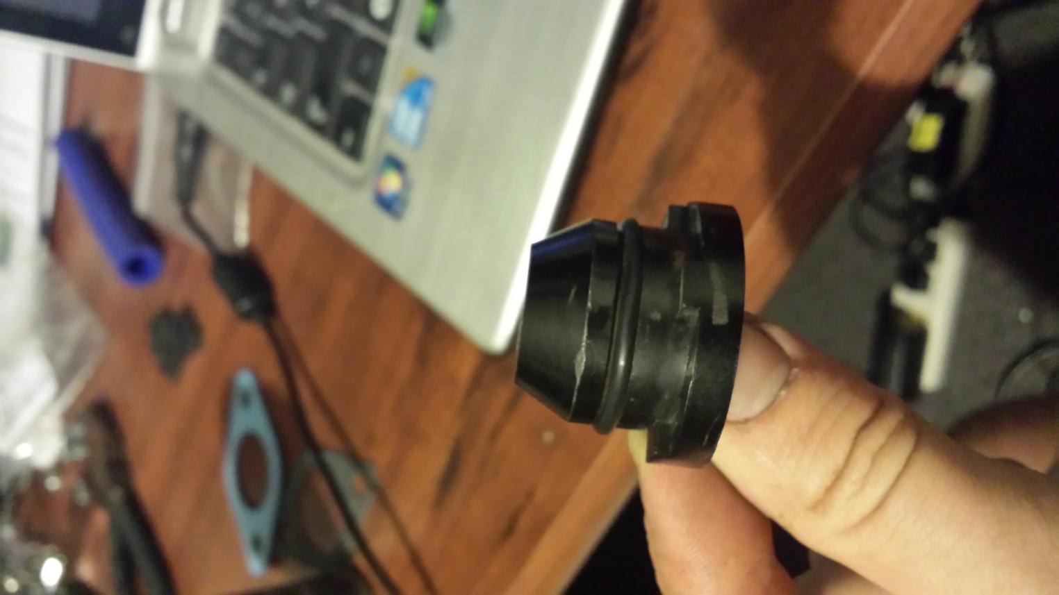

    Next issue. Its kind of a small thing but its turning out to being the only thing preventing me from putting my whole motor back together. The insulator that goes in before the injectors, there is an O ring that goes around them. This O ring was brittle and broke off of all 4 of my insulators. I can not find a replacement. I ordered from an OEM site and they sent the wrong size...twice. I estimated and bought O rings from auto parts stores and none of the rings allow the insulators to fit in the provided space. Without an O ring they are loose but I cant find what part I am supposed to replace it with. The first picture is one of the insulator and the replacement ring ive tried. it is a snug fit but wont fit in the insulator slot on the engine. the 2nd shows a side view of the insulator. Does anyone have any idea what i need to put around this thing to make it work? Dont say order from OEM because i did order part 23250B and got a little grommet. as you can see there are two VERY different sized parts named 23250B on the toyota part diagram.Name:  fuel injection system OEM pic.jpg

    The hard plastic piece in your pictures is the fuel injector basket. That big o-ring is the fuel injector basket o-ring. It's Toyota part #90301-23004. Here's a link to a thread that gives part numbers and much more information on all the injectors and their o-rings/insulators: http://www.toyotavantech.com/forum/s...ng-Head-Gasket.
    When it comes to injector o-rings, for the last several projects I've been relying on aftermarket parts from www.rockauto.com & was happy with results. They sell kits there with all the o-rings and it's much cheaper than purchasing OEM from Toyota. Good luck. Tim
    PS: Don't forget to grease them up. Always be gently when pushing in o-rings and make sure all old o-rings and debris are removed from bores before assembly. Install each part with hand pressure only (don't use bolts to force them in).
