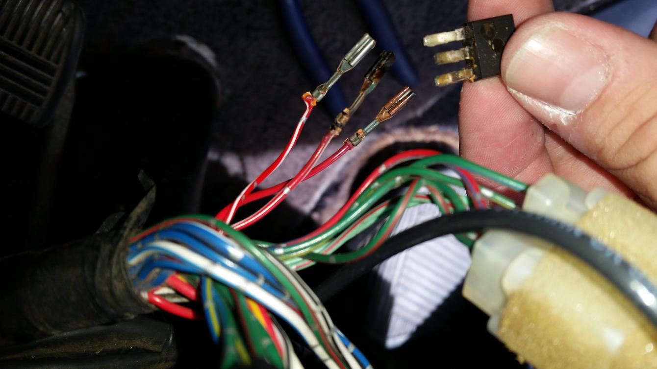

    Looking for some info on what I think is a diode. Its in the wire bundle at steering column. Orange plastic is melted. Has 3 wires red red white.
    on tvp there's a partial thread where wonder wagon references kcg795 and says that this is a diode.
    My girlfriend just bought an 89 van 2wd. Headlights don't work. P.o. bypassed with wires to lights into cab and a hot wire to make them operate at night, and unhook when done driving.
    starting my trouble shoot, and found this melted orange diode. Three wires.
    I did a search for orange, headlight, diode and got no matches. Has this been discussed before? Anyone have info on the wires to this diode? Maybe I can bypass if nla from toyota

    Ok, so this orange diode definately has to do with high beams. It is melted. Would it cause the headlights to not work at all?
    I cannot find any replacement, so i am wondering what the work around is, i cant fing kcg's old thread about modding the headlight circuit, i am thinking maybe a couple fuses and just make the highbeams and low beams turn on when the high beam stalk switch is used? Anyone? Bueler?

    So if i can find a diode that has three legs, i could maybe splice that in? I like my marker lights. I would probably even be willing to settle for always on.
    Im trying go wrap my head around this
    So that orange diode, when i have headlights on, and also turn signal, then it supplies power to either marker light?
    Maybe i would need to look at a wiring schematic, but i would think that it would beed two diodes, one for the right side signal, and one for the left, other wise it would need other diodes elsewhere. By the way, i cannot find this diode in the wiring diagrams.
    I know that if i hookup two of the wires from the diode, the high beams come on.

    Ok partial update. I think the previous owner put the high beam pigtails on the regular headlights, possibly causing this issue with the diode burning up?

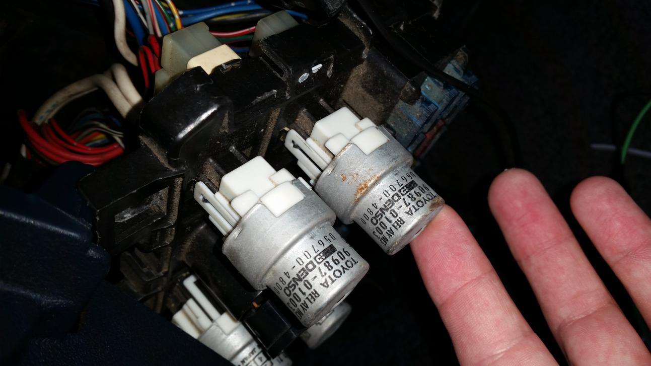

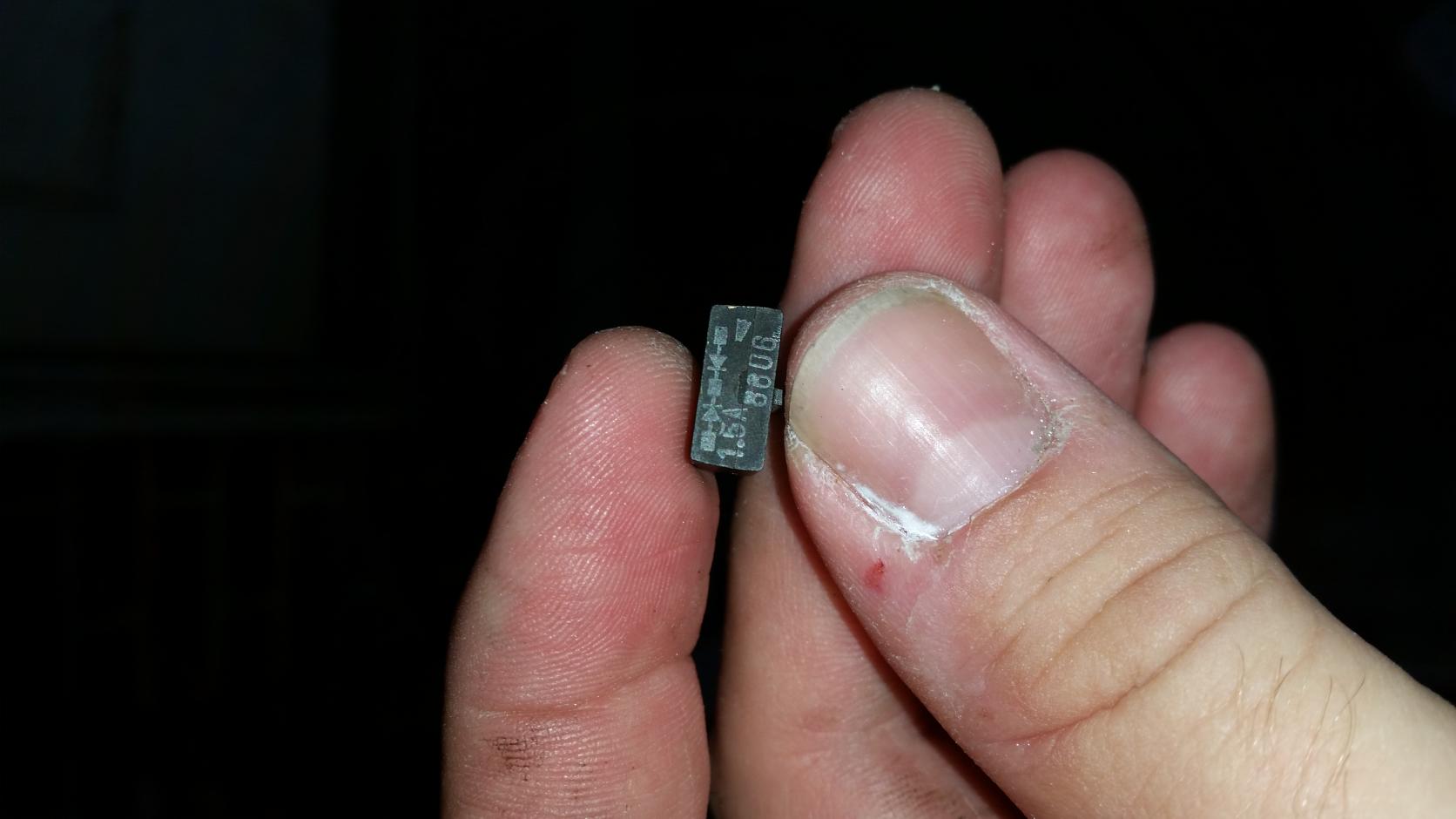

    The diode has 3 wires, two red with white stripe, one just red. When the two with white stripes are touched together, a relay clicks. It is the bottom right relay in the fuse block. I dont have an 89 manual, i do have 87, and 84. I cannot find this diode in the wiring diagram... maybe im looking in the wrong spot?
    Seems like fuseable links are all good, this vanbhas codes for tps, ign, and o2 sensor, and the headlight wiring was vypassed by previous owner. Name:  20150927_140741.jpg
