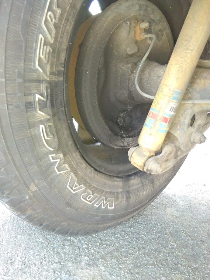

    Rear axel seal
    I have replaced my rear axel seal 2 if not 3 times. But it continues to make mess.
    I use name brand parts. Grease the lips and install the axel gently.
    I also use sleeve lock to keep the bearing in place. Bearing is new.
    It is not brake fluid.
    Any advice????

    Re: Rear axelv seal
    I know you've probably already checked this but I'm gonna throw this out there . Have you checked the axle breather to make sure it's not stopped up ? If it's stopped up the pressure builds inside the axle and leaks out the seals .

    Re: Rear axelv seal
    Have you checked the differential vent? If that's not able to vent properly there can be a build up of pressure, causing seals to break at different parts of the axle. For me the clogged vent caused the pinion seal to bust on my van, but on my 4Runner this same issue caused the driver side of the axle to weep diff fluid just like on your van. Replaced the seals, thoroughly cleaned out the differential vent, and no more issues!

    Re: Rear axelv seal
    Thanks,
    My breather is good. When I rebuilt the diff I took the opportunity to remove the old breather and plumb my own sintered brass fitting up against the floorboard for water crossings.

    Re: Rear axelv seal
    Did you inspect the axle to see if there is a groove worn into it where the seal rides?
