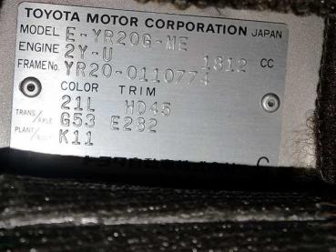

    Otherwise I apparently gotta find a frame number to look up parts? Where do I find frame number ? Apparently that matters...

    The frame number is located on the front passenger side, beneath the seat there should be a square carpet patch you can pull down and there'll be a metal plate with the frame number, chassis number, color code.... ect.
    I save a photo copy on my phone so I have access when I need it. Here's an example-
