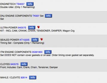

    I have found some other brandsunder that link https://www.rockauto.com/ The brands are
    ENGINETECH TS4057
    DNJ ENGINE COMPONENTS TK937
    ULTRA-POWER 94057S
    SEALED POWER KT1022S
    TM ENGINE COMPONENTS 05391900
    CLOYES 94057S
    MAHLE / CLEVITE 92614
    Do you have any experiences with one of the brands? Any recommendations?!

    Here, here, and here are good places to start. The long and the short of it is that there appears to be interference issues with the aftermarket timing sets. You could spring for OEM Toyota parts (more expensive) or take your chances on a cheap timing set and take the very likely odds that you'll have to take the gears to a machinist to have them properly worked. The aforementioned links should get you going in the right direction but plenty more information is available with a quick search of the forums. FWIW, the ULTRA-POWER set at Rock Auto should probably be avoided.

    Since it's the timing gear that seems to be giving people the most problems, I'm wondering if it would work to buy just an OEM timing gear and then use the A/M stuff from one of the kits. That way it only tacks on $40 to the kit price instead of going the whole $400.

    As far as replacing the chain and gears - I chose to go OEM, simply because I knew there would be no guess work involved.
    Everything fits perfect, every time.
    Your going in DEEP and will be there for awhile, do you have time/space/money to deal with issues if/as they crop up?
    Repair shops rarely have time for mucking about to make things work and if they do, you WILL pay for that time spent.
    If you have to pay a machinist to modify the "cheap" parts or the repair shop for the down/wasted time, just how much are you saving?
