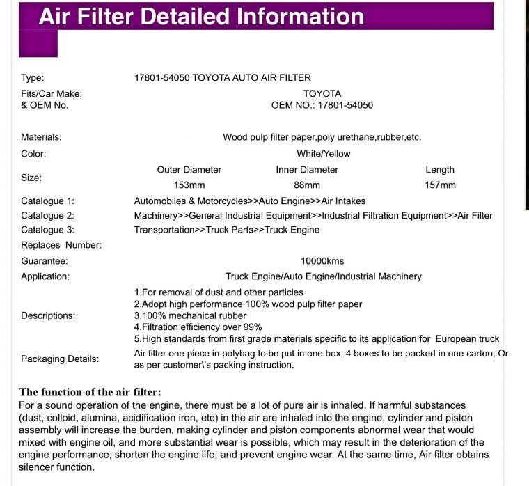

    Hey Guys!
    Any of you know the part number for our air filters? I know the toyota part is 17801-54050, but I cannot find a Napa or Wix equivalent. Any help here would be awesome...Thanx!

    My TownAce is petrol/gas version so I use the OEM filter but here's some specs about the filter your looking for-

    Hey JDM VANMAN! Many thanks for this! I'm going to do a little digging to see if I can find an equivalent size/spec filter and report back. Appreciate your time

    AIR FILTER: WIX 49241
    its 1-2 mm off but looks like it will work
    They had to order it at O'Reilly but said it would come in 1 day for $39

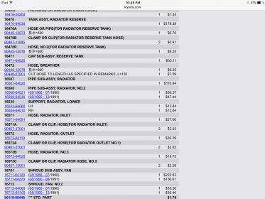

    I want to replace some of the radiator hoses on my townace. Is there an easy way to look up all the part numbers? a good diagram? Are auction sites the best place to source these?

    Did you try inputting your chassis code on toyodiy?
    Here's an example of CR30G-PEZX

    Oh man sorry it came out blurry it always does that off of that site.
