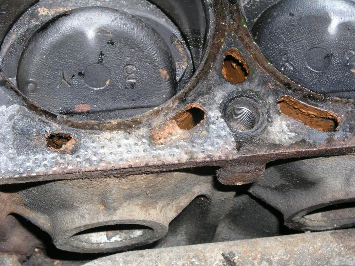

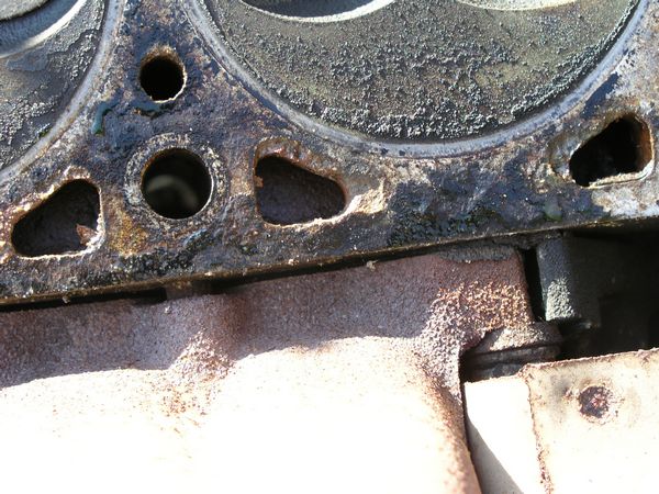

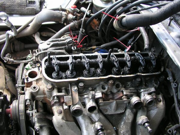

    Well, I took the head off today, finally. This is my busy season, with my work, but I found myself with a day, so I dove in. Thanks for the link to the manual, although the guy I bought the van from had given me that same manual. I was able to print a couple of the pertinent pages (head bolt removal sequence) from your link, though, so that was a plus.
    The inside of the valve cover was pretty gunked up (first picture below), but I blew that out (after removal). I will inspect the valves, etc. on my next day off, to see if I need to get them ground.

    I didn't see any direct conduit from the water jacket openings to the cylinder, so I'm a little puzzled as to where my coolant may have been going. I'm kind of keying on #2 cylinder, due to the compression test and did see a less than perfect area around one of the water ports next to #2 (first picture below). It's kind of "dished out" around the port. The head gasket is sort of eroded around that port, too.

    The block and the head are flat. There was a lot of buildup in the water jacket ports (rusty looking).
    The coolant in the overflow tank is a bit murky, so I still suspect the head gasket.
    I'll be proceeding with my project, but if anyone has any ideas along the way, I'm open to your thoughts.

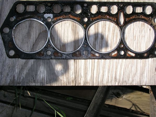

    Sorry for the late reply Skibum, glad to see you're getting elbows deep in a HG replacement!
    Definitely looks like your HG was in the beginning stages of blowing -- good to see that its being taken care of now. Post a video of your Van running when its made a full recovery!

    The head gasket looked like it might have been leaking between a large hole at the front of the engine and Cyl. #1. There was some "shellac" on the steel ring in that area and the exhaust valve for #1 was quite a bit darker than 2, 3 and 4.

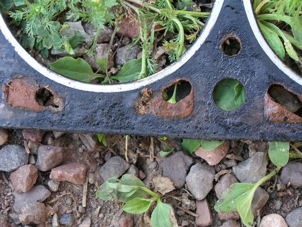

    In Canada the list price for them at the dealership was $3.40 per gasket . I ended up buying four just incase. (They told me there were only 93 left in their whole inventory.)
    Happy Wrenching!
