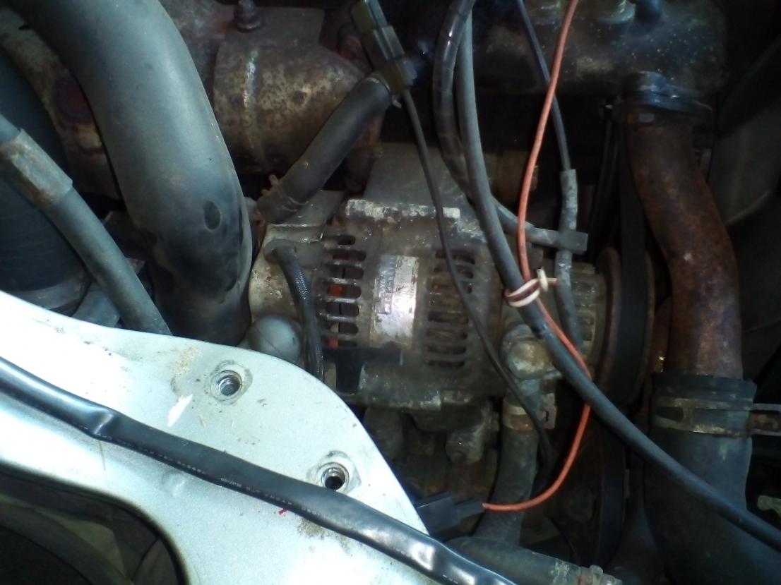

    The alternator, which is special: it is also the vacuum pump for the brakes:
    If anyone has an idea, I will be happy to know it :-)

    That alternator is looking pretty crusty. If outside of your skill set, I would find someone to test the alternator for you either in the van or removed. Also it would be better to post this in one of the alternator/Christmas dash threads so all this info stays in one place. Maybe a moderator could move it.

    Thank you for your answer, you were right! I solved the problem two days ago, and I was going to write the solution here soon.
    It was indeed the alternator, the rotor was dead, I removed it (not easy with the air and oil pipes of the vacuum pump!) and luckily find a new one in a wrecker.
