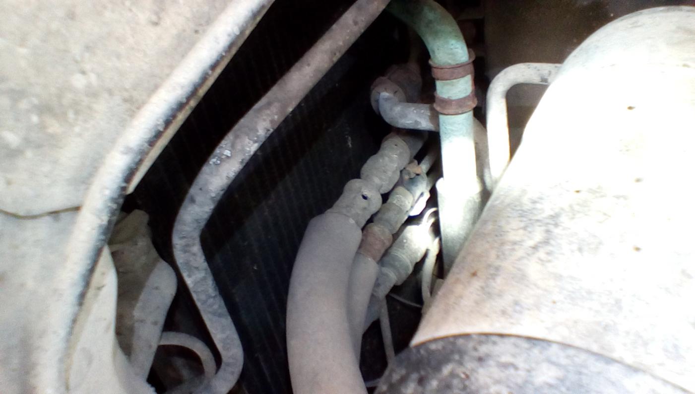

First pic is from passenger side with receiver/dryer in the right foreground. The flashlight beam is focused on the wires for the upper switch. There is actually two of them. One on top of the pipe and one below.

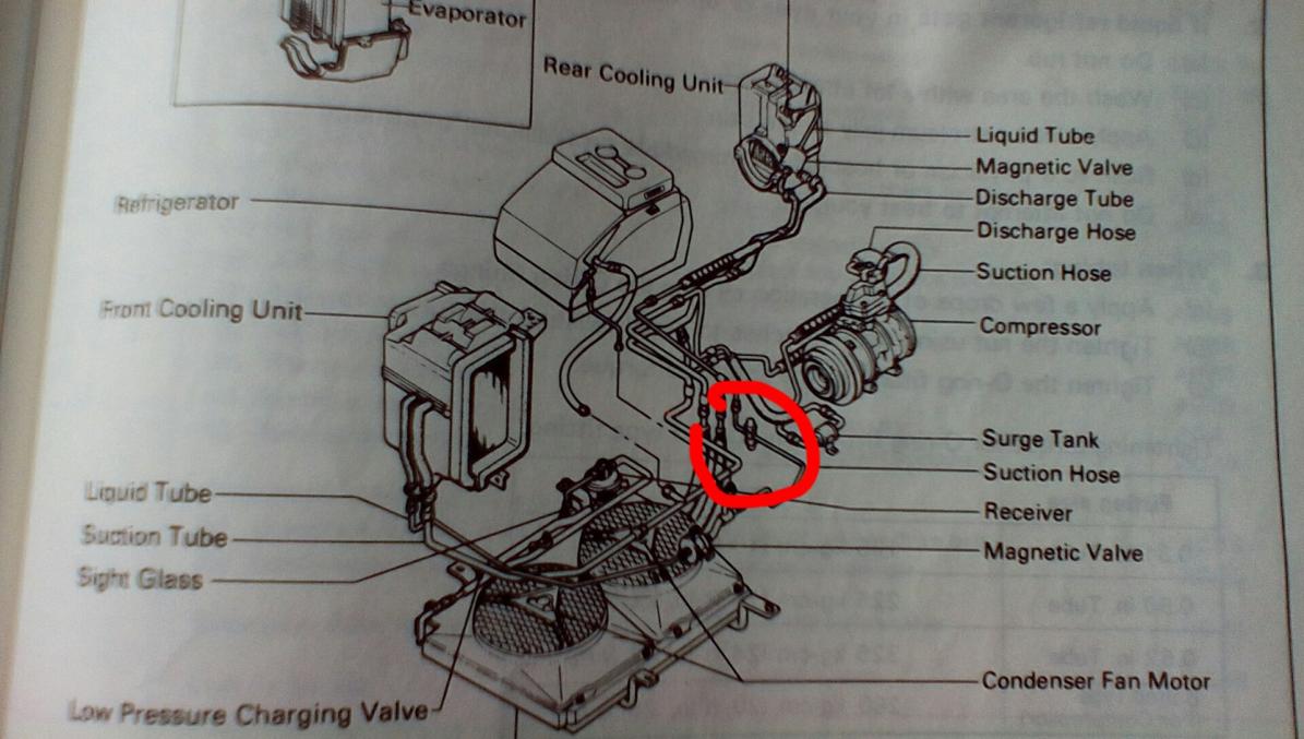

I circled there location in the diagram in my manual. I suspect the '87 manual has the same pic as my '88 manual but I don't know why they didn't label the pressure switch in the 4WD diagram.

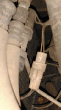

Great picture, thanks! I found mine just where you said it would be:
I don't know why there are two of them; more study required.
There are two connectors, one white one between the switches, and one where they go into the harness, Do you know if I can just put a jumper in the connector between the switches, or is it the other one? They're easier to see than to reach, from below for me, anyway.
