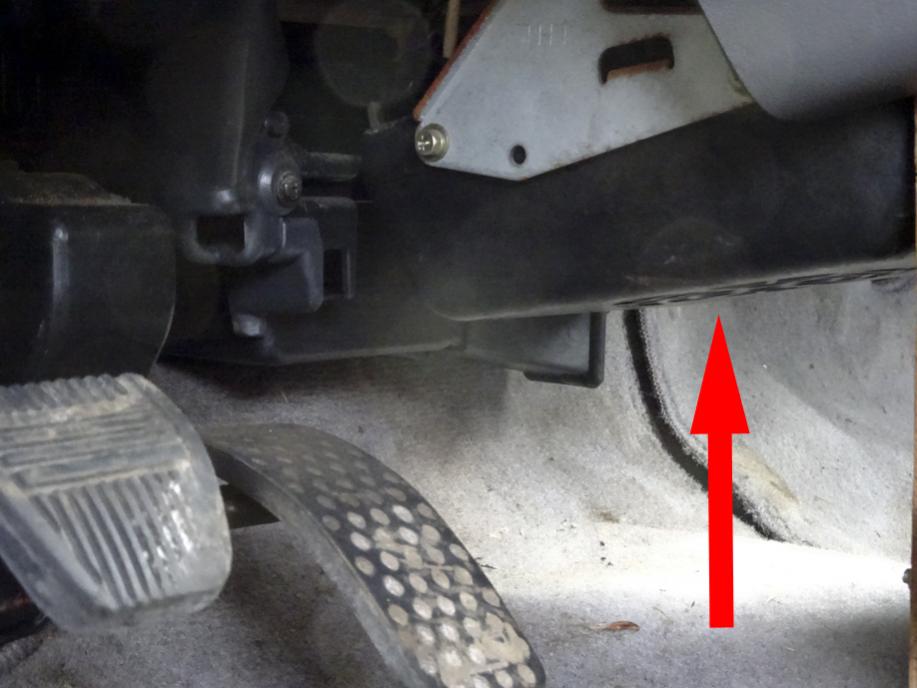

    Is this sub on all the vans or only certain trims? Where would it be hiding if it was on my van?
  19. #19
    Administrator llamavan's Avatar
    1985 5-sp cargo (Trustyvan) . . . . 1989 5-sp 4WD DLX (Skylervan)
    PNW
    1,803
    Re: OEM subwoofer (LE Vans)
    The OEM subwoofer is only on the LE trim vans. If you have an LE, look to the right of your accelerator pedal. It's the bottom item of the OEM stereo component stack.

    Oh that is perfect! Mine has the woofer as well, although it is mounted vertically, maybe because it has the fridge.
    I was not going to use the woofer, but it is absolutely the perfect spot to mount an amp!
    Anyone wants my woofer? It looks in descent shape.
