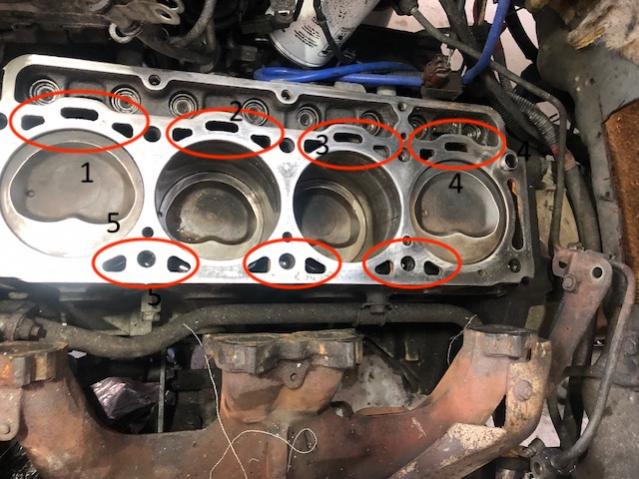

    Hey Tim:
    I am changing my head gasket and when I compare the new with the block the holes are different where the water jacket is. Can you take a look at these pics? They use holes in some areas and not triangles.
    I made red circles around where there are holes on the gasket and then where they line up on the head. You can see that only 4 triangles are on the gasket compared to 7 on the block. The remaining are just holes.
    Do you think this was done intentionally?

    What brand gasket is that? I believe the OE Toyota head gaskets to be NLA, but if you can get one of those, that would be my 1st choice. FWIW, I don't know a lot about why the gaskets don't always match, but IMO, I think the casting holes are only approximate and Toyota likely dials things in with the size/location of the holes they put into the head gaskets. I don't have a lot of trust in aftermarket brands, but I totally trust Toyota gaskets to be accurate and of high quality. I just dug out one of my OE Toyota head gaskets and snapped some pics for you to compare:

    It is made by Fel-Pro. It is the same one I got the first time. But your pics tell a thousand words. Mine is idenical to the OE Toy. The head did not fail on its own. The hose of death broke just as it is leaving the head. I was on the highway at 3200 rpm and did not catch the temp meter in time. The head got warped and piston 2 and 3 lost compression. Turned out the valves in 2 and 3 were also killed. So I have my newly made head and the same head gasket I had before. So I will proceed today getting her re-assembled.
