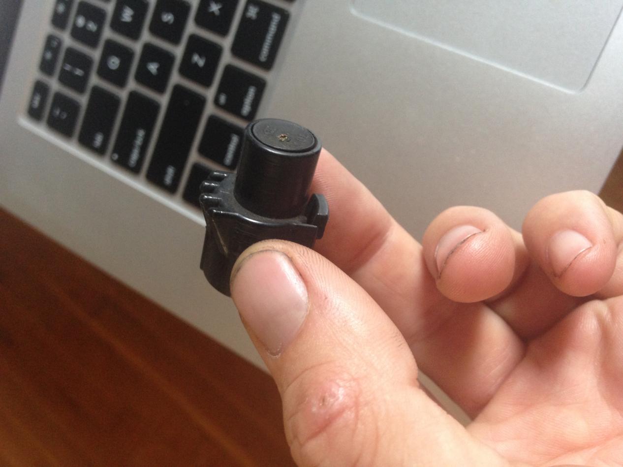

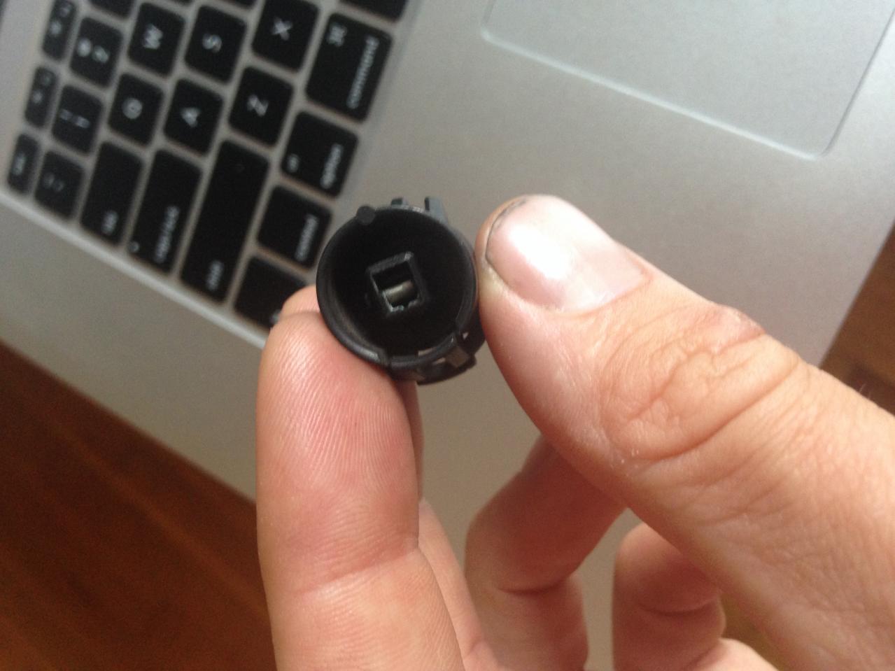

    1984 Toyota Van LE
    Nov 2014
    Evanston, WY
    4
    Re: Identify these things for me?? Pretty please?
    Thank you for the information. I don't think the switch itself is bad, just the wire boot thingamajig is broken. I'm assuming it is only essential for cold starts, but now I need to know how to find the wire/boot >.> Hmm. I'm also assuming that the hose is actually supposed to be run where it is run.. which seems like a bad design to me, but the picture you posted shows it is run that way as well - so maybe I can just fab something to keep it from pinching against those switches.
    It's a standard Bosch type injector connector. It doesn't need the boot, but the wires will last longer if you put some shrink tube on them or wrap with electrical tape. Here's a post where I'm using these for my injector harness. With shrink tubing on them they are protected and the wires won't break off from excessive flexing. Tim
    http://www.toyotavantech.com/forum/s...2506#post12506

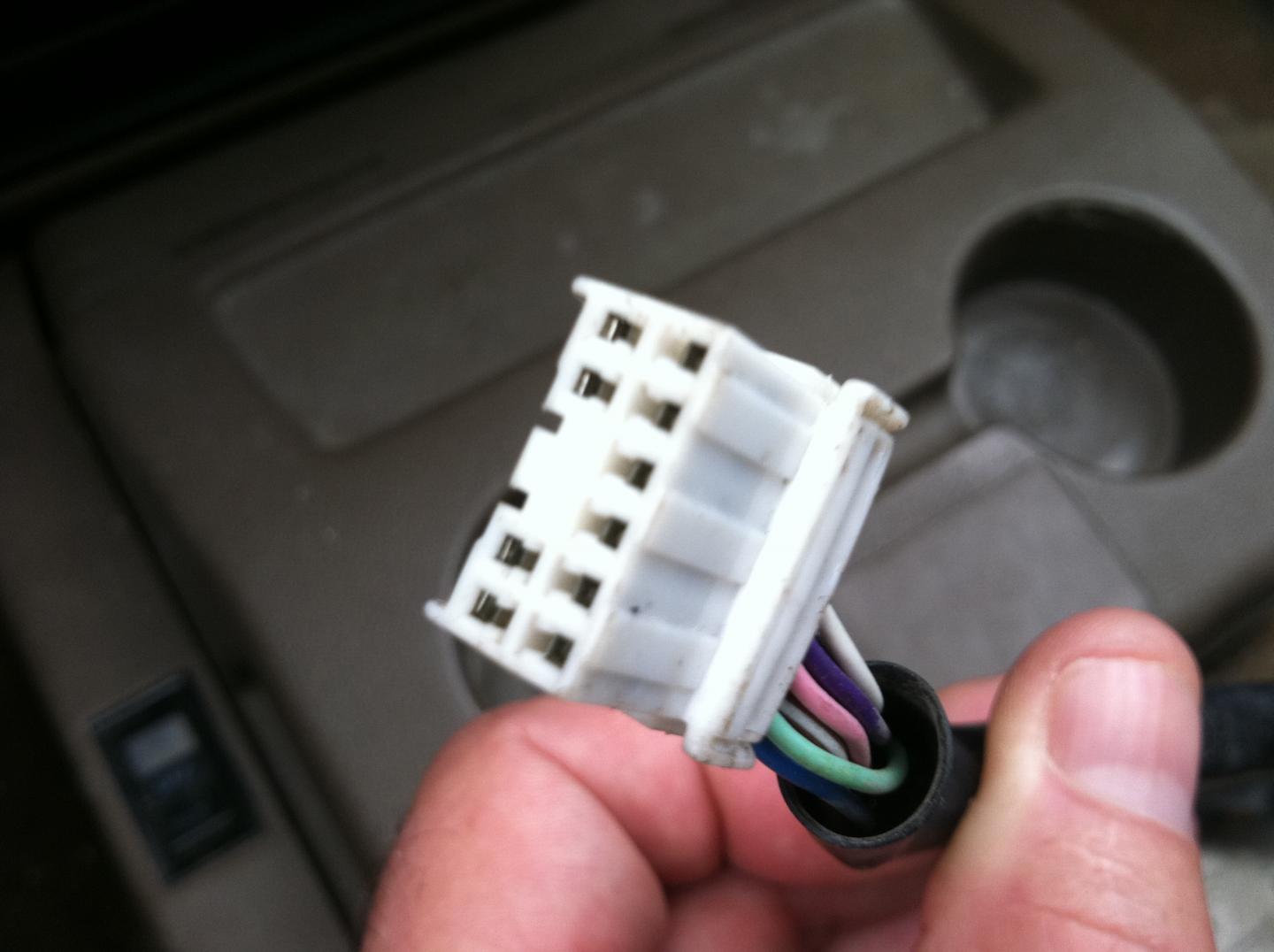

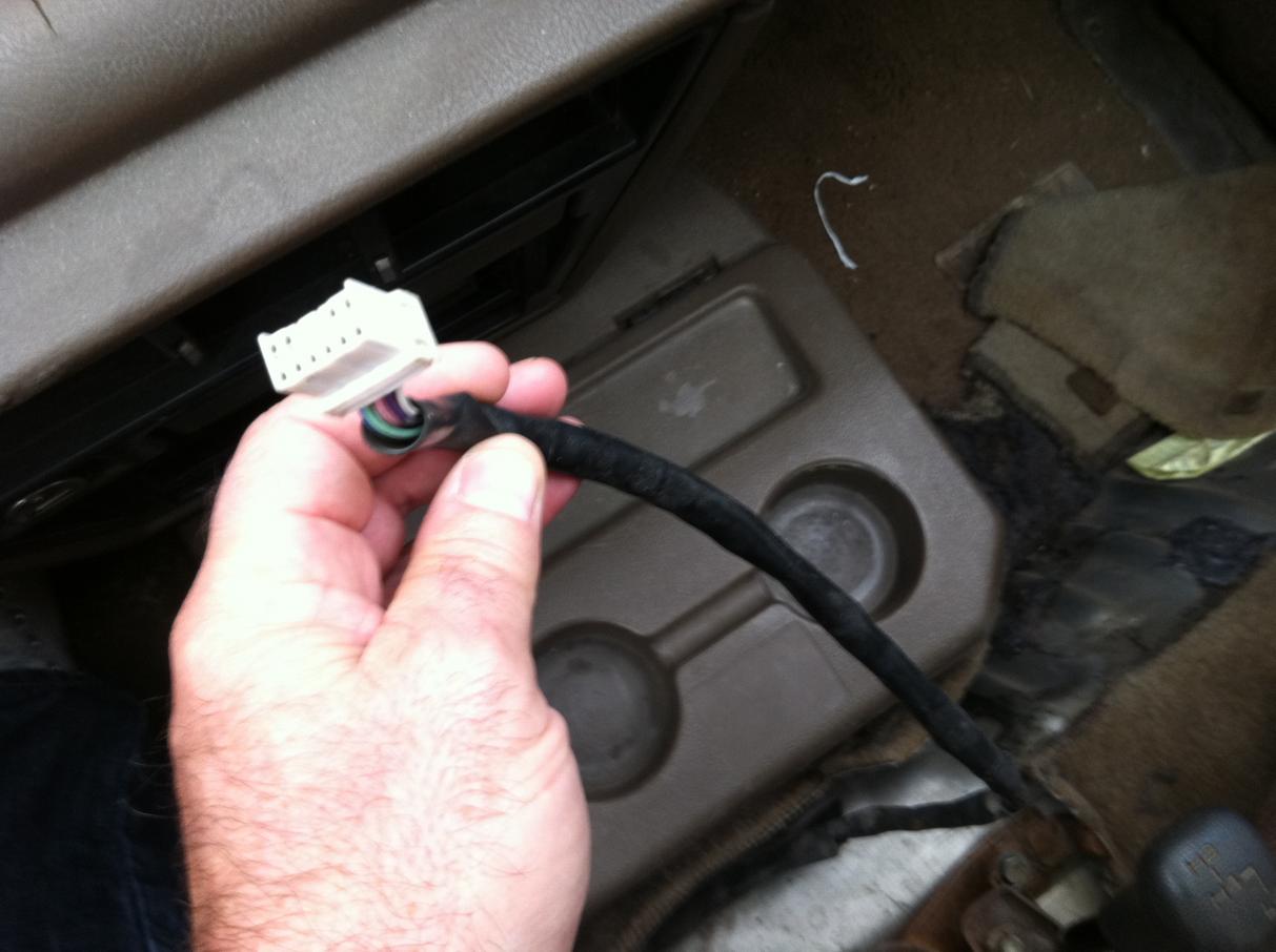

    Possible A/C electrical connector unknown where it ought to connect
    I have reassembled a basket case 1987 4x4 manual with cooler by shift console. There is a connector on a rather longish set of smaller gauge wires, a 10-pin connector, coming from under the carpet. I see no where to plug this. I am just about to get AC put back together. I have the repair manual, and have looked at the AC schematic. Wow very complicated! There are no wire color codes. Can anyone tell me where this plug might reach to. It is long enough I think to reach up under dash, it might reach into cooler somehow.

    Re: Possible A/C electrical connector unknown where it ought to connect
Size:  84.7 KBName:  IMG_1364.jpg
    Here the photos. So where does this connect to please?
    That's for the "Audio Control". Behind the shifter on the center console there was a remote control for vans equipped with OEM premium sound systems (double din AM/FM Cassette stereos). It's there so you can adjust volume and change channels easily (no leaning down while driving). If the original stereo has been replaced, then the original "Audio Control" would have become useless. They likely removed it and put something else there. If your original components are still there, you might try plugging it in to see if it still works. Tim

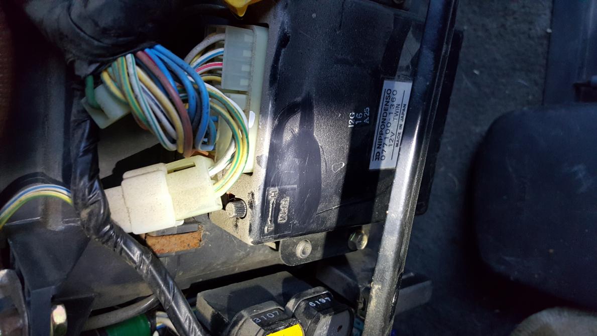

    What is this?
    While messing around looking into putting in a kill switch I saw this part pictured. It has an adjusting knob that says RPM. What is this and what does the knobest adjust? Is it for the blower? Thanks!Name:  20151008_183118.jpg

    Re: What is this?
    I could well be mistaken but I think that is the ECU for the AC, I would tend to leave that knob alone.

    Re: What is this?
    That is the ac amplifier which is essentialy the ac ecu as burntboot said. The rpm knob is to adjust the low idle speed at which the ac clicks off. It's usually set at a high enough rpm that it will not run the ac at idle speed so it won't overheat the engine in hot conditions when the van isn't moving. I've fiddled with mine a bit and I know Tim has posted about adjusting his too but he also stated he has a engine temp switch that shuts off the ac if the engine gets too hot. If you must fiddle with it(That's how I figured out what it does.)do so with caution.

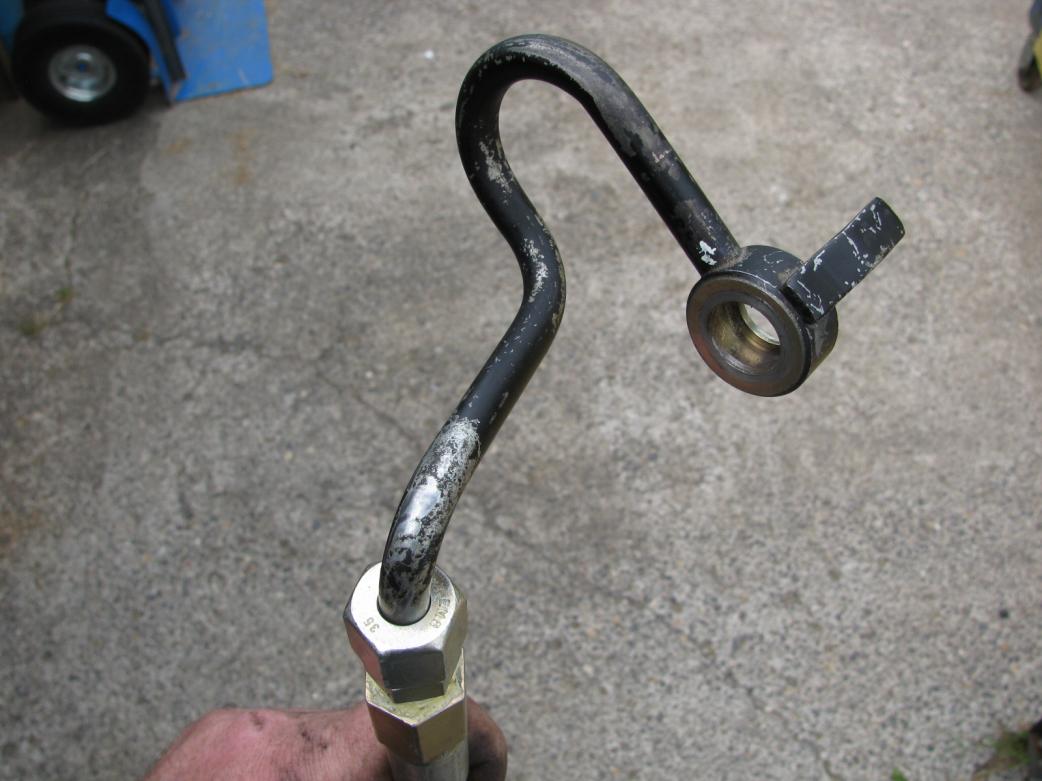

    Question about power Steering Banjo Fitting on 89 2wd van
    I've got a pretty bad power steering fluid leak so I took my van (89 2wd) down to the mechanic. He said I needed a new high pressure power steering hose so I ordered this one: http://www.autopartswarehouse.com/sk...3-1753585.html
    I took him the part and he said it didn't fit the van. He showed me a banjo connection, which looks like this (this is someone else's photo from this forum)
    Name:  banjo fitting.jpg
    What is this part in the photo above called? In the link I posted it says "Gearbox side connects to Pressure line #44411-28051"
    Would 44411-28051 be the part with the banjo fitting that connects to the power steering pump itself?
    Many of the posts I've read about this talk about removing the hose and taking it to a hydraulic shop to get it repaired, is that what I need to be doing?
    Is there any other information I could give that would be helpful? Thanks in advance y'all!

    Re: Question about power Steering Banjo Fitting on 89 2wd van
    I picked mine up from RockAuto. I have an 87, but by the looks of things, they are similar. While the banjo fitting and threaded end worked, it wasn't a perfect fit, but close enough that I haven't had any issue with it.
