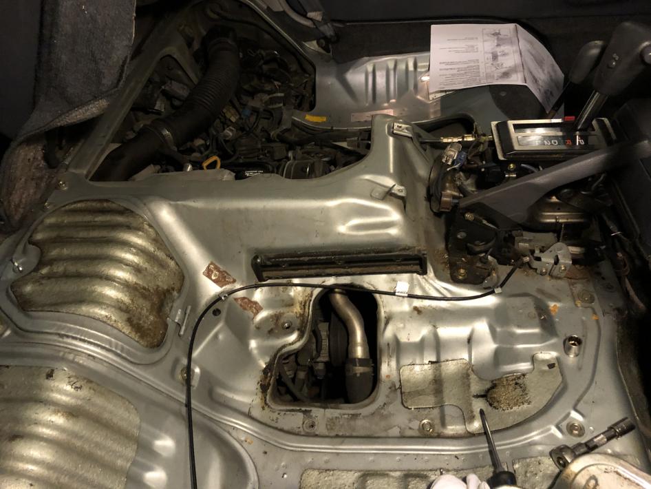

    was hoping there was enough room to get in without removing the driver seat and pan but no luck, maybe if was not my first time but ill need all the space i can get.
    was easier then I expected but of course, removing is always easier then putting back together.

    SO there is a small access under the driver seat, for the veteren maybe possible... I however am a little green under the collar.

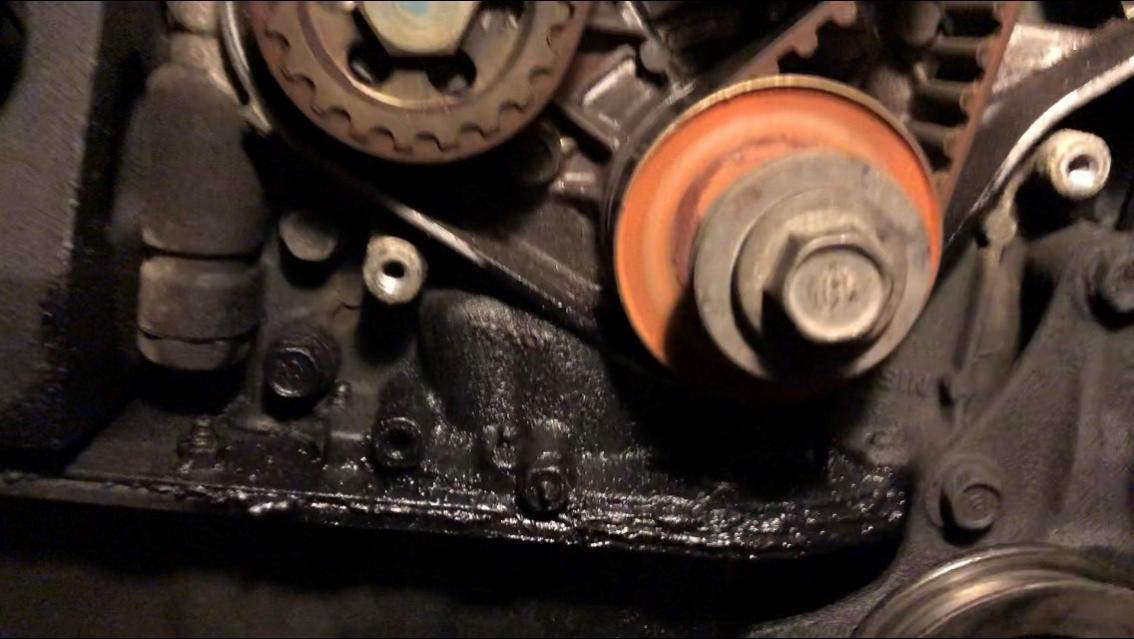

    the belts tensors were easy to get to after that. I got a oil leak...... hands are filthy black, from the last belt tensioner at the very bottom, its called the 'idler' in the manual. you can actually reach it by crawling under the van.

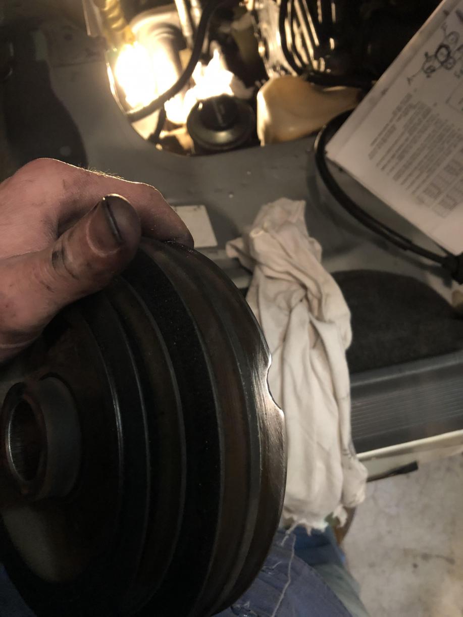

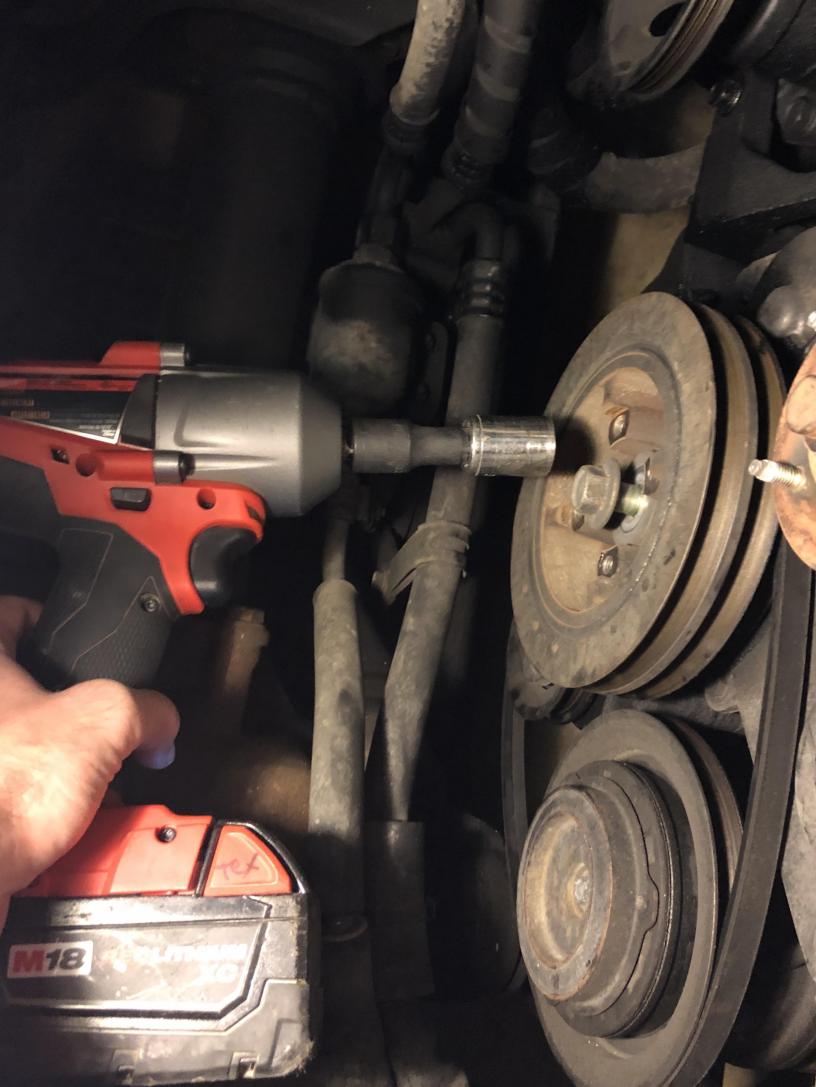

    Next, remove the crankshaft pulley, I encourage everyone to invest in a impact, electric was easy enough to use.
    19mm or 3/4"
    Name:  van 2b.crankshaft.jpg
    and this is where I stopped for the night.....

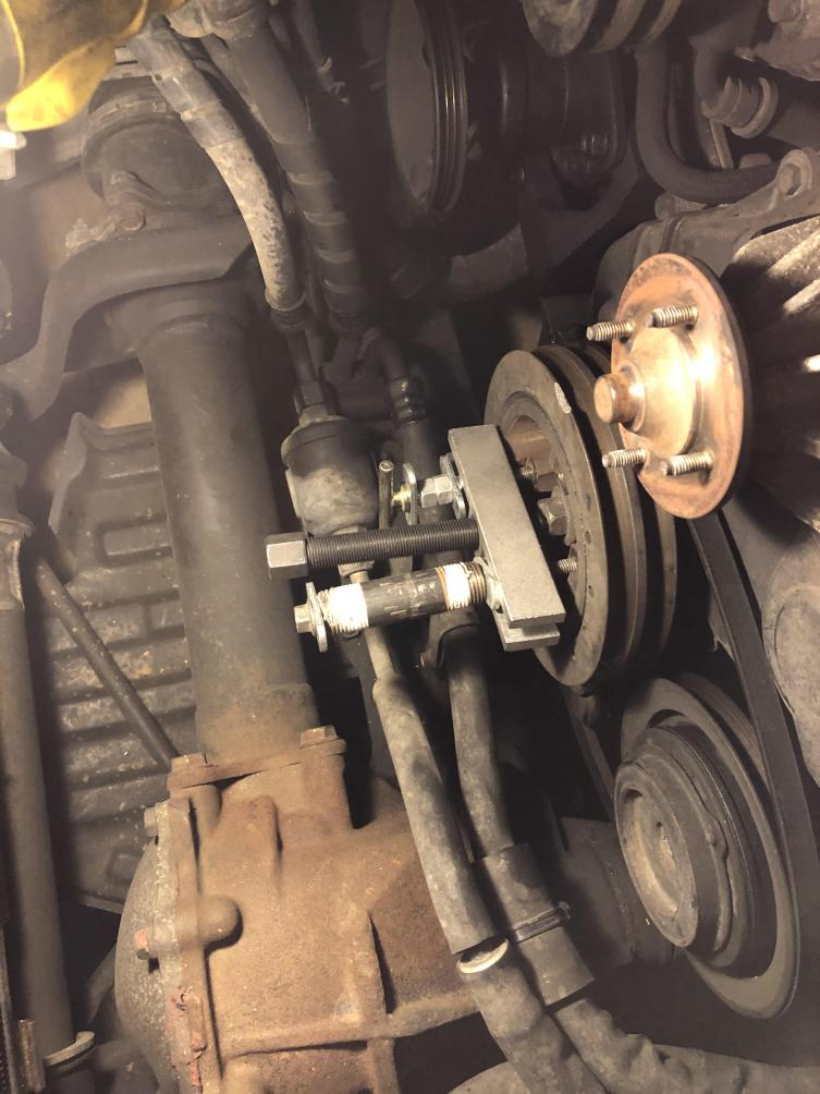

    I don't know what to do. may just grind it smooth and leave it alone... I doubt I can find a pulley this side of the world in decent amount of time.
    The puller tool has wider teeth, all I have to do is rotate the pieces. Tomorrow morning lets hope the pulley comes loose.
    Name:  van 2c. pulleybust.jpg

    I tried to use that style puller also with the same results. You need one that attaches to the bolts, I got one at Autozone. On the TDC you can just pull the timing cover and line up the mark on the cam gear to the head.

    rented the timing belt puller, for all of $16 probably should of just bought it.
    the 2 bolts that it came with are the wrong thread pitch, so I had to improvise.

    To help offset the problem i created by using the wrong tool, I sanded down the chipped part hoping it wont tear into my belt.

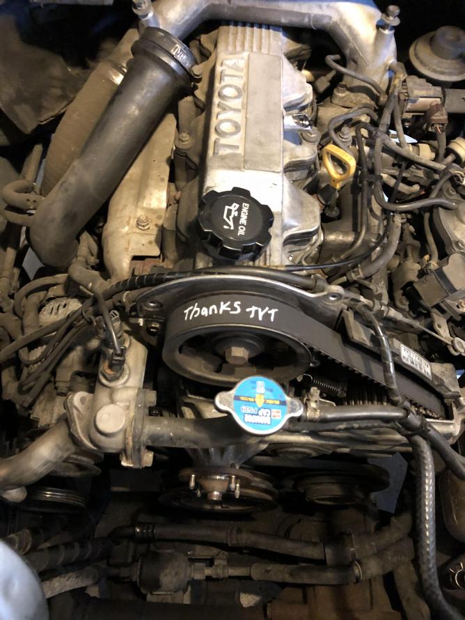

    Well, it went back together nicely....

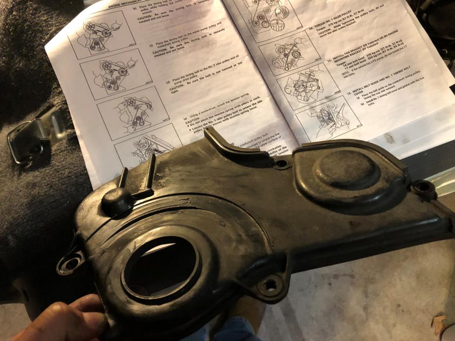

    Not only the oil present but also the cover being tore up were the crankshaft pulley is located.
    The leak is not to bad at this time, so I'll start buying parts to replace those seals (unless you have to measure first), I was reviewing the manual of how to replace the crackshaft seal but was overwhelmed by the steps.
