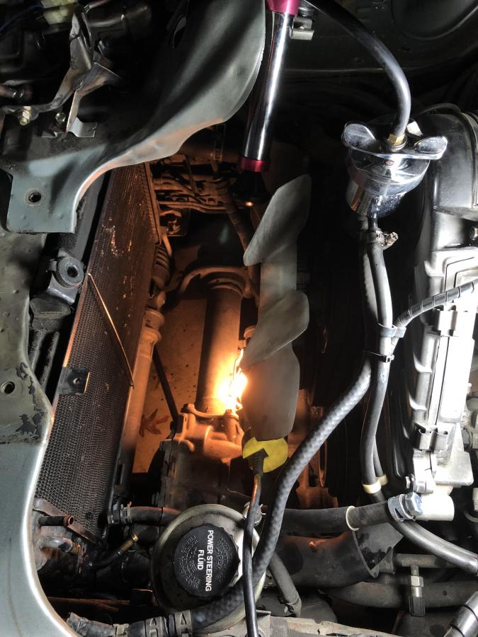

    The van has been running pretty well lately aside from a really weird steering issue here and there but last week I was on my way home when I noticed a puddle of coolant under my driver’s side right tire, I checked my coolant tank and it was far below the low line, I put a little bit more coolant in it and drove it to a friends so I could work on it but on the 4 mile, mostly downhill drive there my temperature gauge made it’s was passed the H even when I toggled the electric radiator fan it was still increasing. When I took a look around it appeared that although my tank was full there was nothing in the radiator cap but I can’t find any obvious place the leak is coming from. It seems to be centralized on the drivers side of the radiator but there’s a lot, dripping off around behind my drivers side tire. When I checked my cap the stem was dry, there doesn’t seem to be coolant running through the system. My oil isn’t milkshakey so I don’t think it’s head gasket related(Hopefully) Any ideas?

    Pressure tester from O'Reilly's is rentable and has been my best friend troubleshooting cooling issues and working on the system. She should be at 15psi, and once up to pressure any leaks/faulty hoses will definitely be obvious.

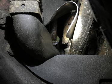

    Quote Originally Posted by originalkwyjibo View Post
    These are invaluable for coolant leaks.
    Thank you, that did help greatly.
    Enough to realize, unfortunately was not a bad hose. Well not that I could see
    Its leaking from the rad., near the outlet hose. very sus
    So I'm trying to remove rad and get a better view.

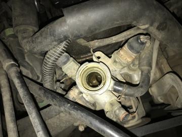

    I think I found the culprit in my case today after trying to refill the cooling system,

    Re: Bad Coolant Leak + Overheating
    Glad you found it, I don't see it. What do you have to replace?
