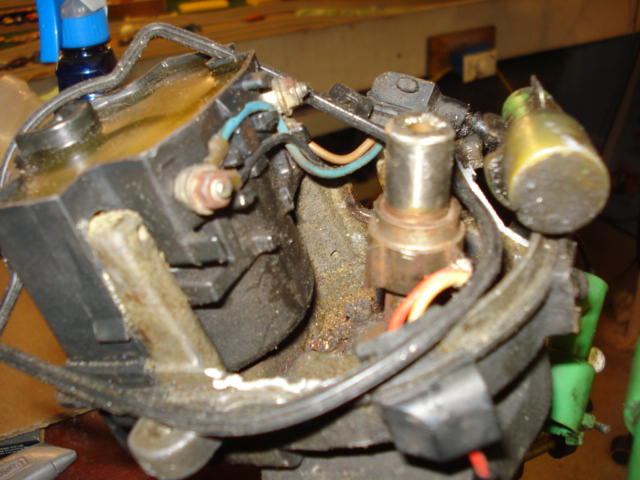

any ideas why it wont come out?i removed the cap and removed the 12mm bolt that holds it in and tried lifting it out ... nothin cant budge the thing. i noticed the the housing is flopping around(like its broken on the bottom)and having a hard time getting it to time correct,so i decieded to remove and swap it with a known good 1.this is the last item to be done and it,s fighting me the whole way! could use some advice. thanx joe g

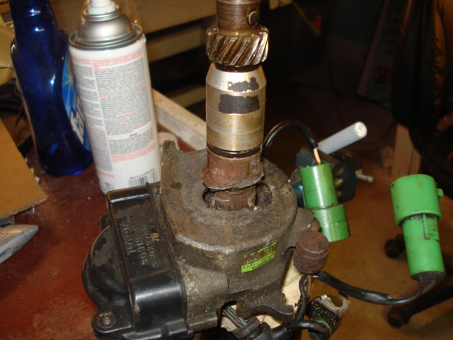

man i finaly got it out. i had to break off some of the housing and use the claw of my framing hammer to get it out .seems after sitting for so many years the aluminium electrolicized together! so if you have a distibutor that has,nt moved in years i reccomend that you check it to see if it will! i cant believe that this thing ran. you can see that it was just flopping around.glad i got this bad 1 out and had others to put in.i have it timed by ear at the moment but i,ll be going in for a real timming soon.
