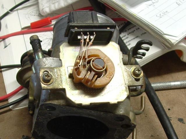

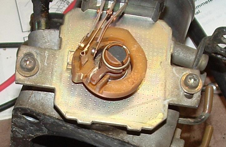

    Got the starter kit off Ebay with the new plunger,about ten bucks to my door, fixed the starter (only 1 worn contact)
    Figured out the TPS is bad, retarded the timing and it passed smog, WOOHOO!! Now I need a TPS and am amazed at the myriad of choices, aftermarket and factory.
    Anyone have any good or bad issues with the aftermarket? It's not something I wanna do twice, but I'm also on a tight budget and $30.00 bucks is a lot easier to stomach than $70.00.
    After pulling the throttle body today, I attempted to figure out what actually failed on the TPS.
    after removing the cover the problem was glaringly obvious, the plastic arm was wearing its two contacts so bad, there was way too much slop, and the points could not be calibrated anymore. The plastic is also turning to powder, accelerating the wear.
    The joy of desert living. Then again, this has 186K on it and it's 25 years old almost. Onwards and upwards!Name:  tps gap.jpg

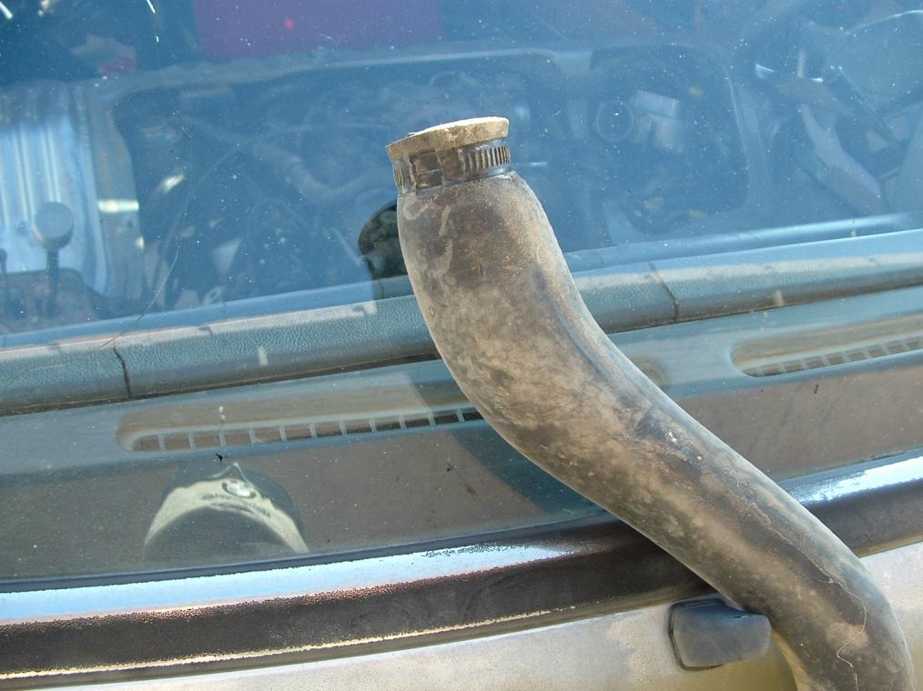

    New TSP installed and adjusted, repair the pulled wires for the vacuum switch that sits next to airbox, replaced coolant hoses for throttle body, reset the timing correctly adjusted the idle speed, and now just thinking a new cap and we're good to go. I don't think it's releasing any pressure, since the label on it is bowing out, and has pressure under it. Is this an 8 pound cap?
    Sure runs sweet, now I can't wait take her for a spin!
