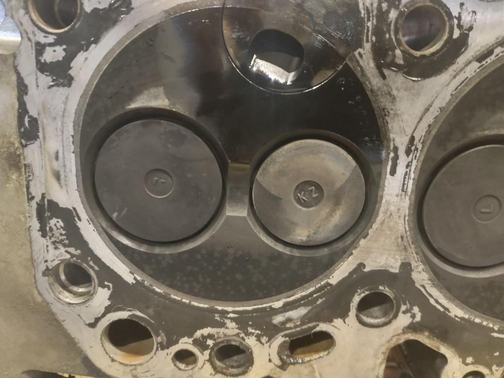

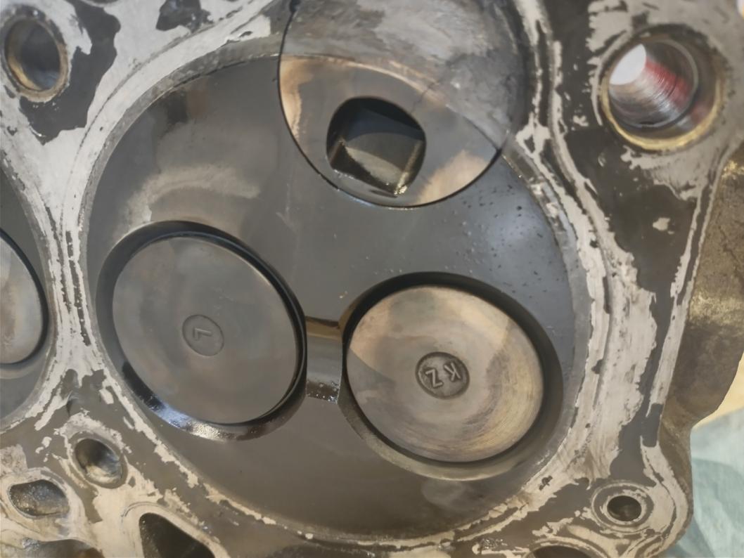

    Ok, I've gotten the head off and have a pretty good idea of the extent of the damage.
    The cam is snapped in 2 places. You can see dents from the cam lobes on the intake valve shims of cylinders 1 and 2. Perhaps this is where the unstoppable force met the immovable object. The second bearing cap was completely shattered as you can see in the first pic. The bolts for the front two bearing caps were bent quite a bit. Also the right side mounting post for the bearing cap that broke has some damage.
Size:  90.8 KBName:  IMG_20220628_165109182_HDR.jpg
Size:  90.6 KBName:  IMG_20220628_164829028_HDR.jpg
Size:  91.5 KBName:  IMG_20220628_165029846_HDR.jpg
Size:  83.5 KBName:  IMG_20220628_165005328_HDR.jpg
    As far as I can tell, the valves didn't touch the pistons. The order of the pictures is front to back - Cylinder 1, 2, 3, 4.

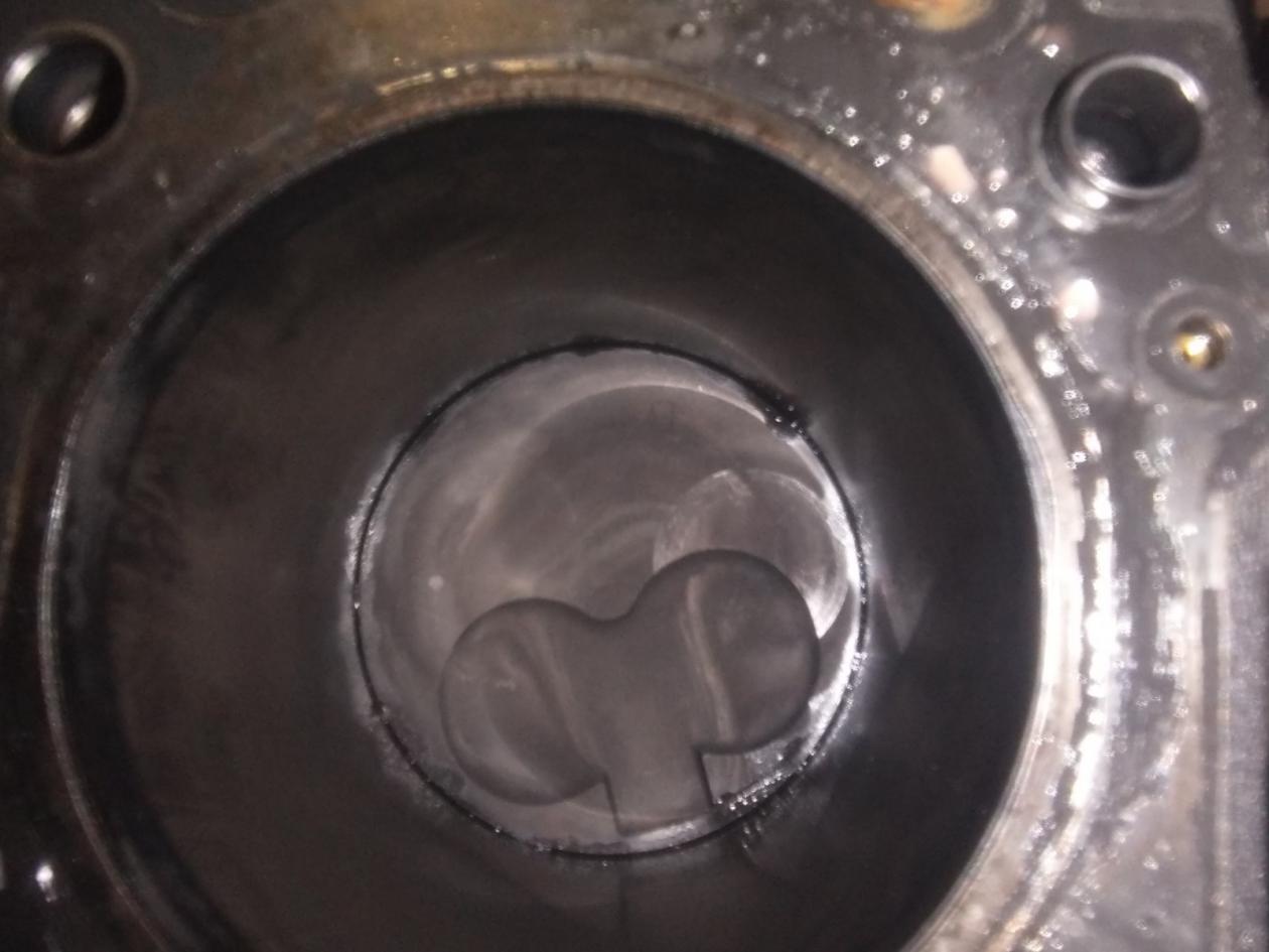

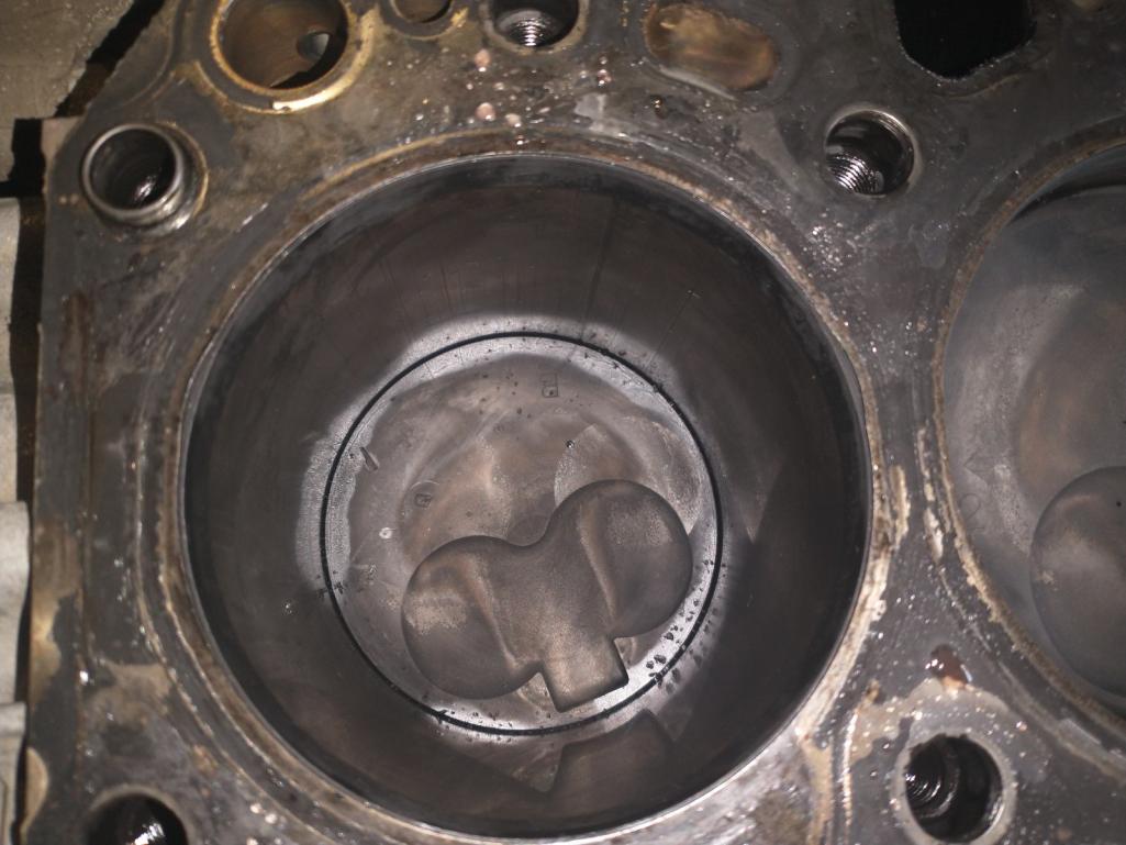

    Pistons look untouched as well. #1 has pitting on the piston face and scoring on the cylinder wall, but I don't think that's associated with the timing belt failure. Maybe a melted injector or glow plug tip in the past. Again, 1, 2, 3, 4.
Size:  92.6 KBName:  IMG_20220628_175009760.jpg
Size:  89.2 KBName:  IMG_20220628_175015510.jpg
Size:  86.2 KBName:  IMG_20220628_175019761.jpg
Size:  86.6 KBName:  IMG_20220628_175031728.jpg
    So with the damaged bearing cap mounts I guess i need a new head. not sure if Ill buy one that's ready to install or build one myself. I'm also wondering how much of a problem the pitting and scoring in cylinder 1 is. Do I need to pull the block and have it honed or re-sleeved? Or can I just clean up the pitting and forget about it? I'm also going to disassemble the head to examine the valves more closely. Looking through the intake and exhaust ports they don't look bent or broken. I'm scratching my head a bit as to how that's possible.
