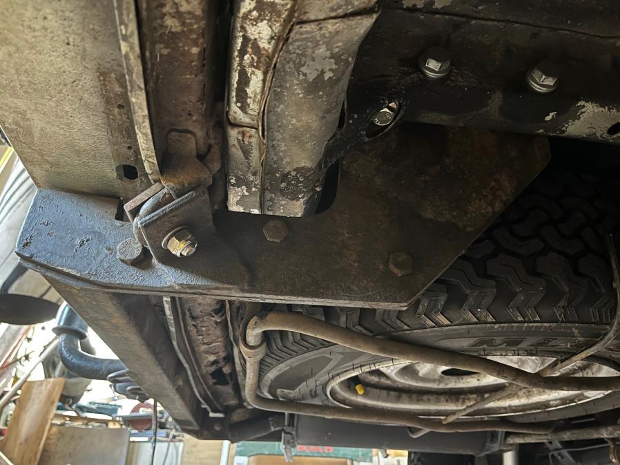

    Re: installing a hitch on a 1987 Van Wagon
Size:  97.6 KBName:  IMG_3116.jpg
    Maybe for inspiration... I know we have a different style of hitch over here.... But it is just two plates of heavy steel cut out, mounted directly on the frame rails, and a bit of rectangular tube in between. It is also connected to the rings on the bumper, but I can't imagine that adds much. It does not interfere with the spare wheel. It did interfere with one of the exhaust hangers, but that was easy to fix.

    Quote Originally Posted by Jan-Willem View Post
    Lol, based on the rust holes on your bumper, I would tend to agree . Good design though, if not for the rust weakened bumper, that appears to be a nice strong hitch. Tim
    Hehe, yes, I have since I took that picture, rectified that situation. I still need to do the front bumper though, both constantly sprinkle my driveway with rust flakes.
