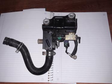

    This is the heater control valve from a late 80's Supra it does require vacuum and electricity. vacuum being the tougher of the two and you get only on and off
