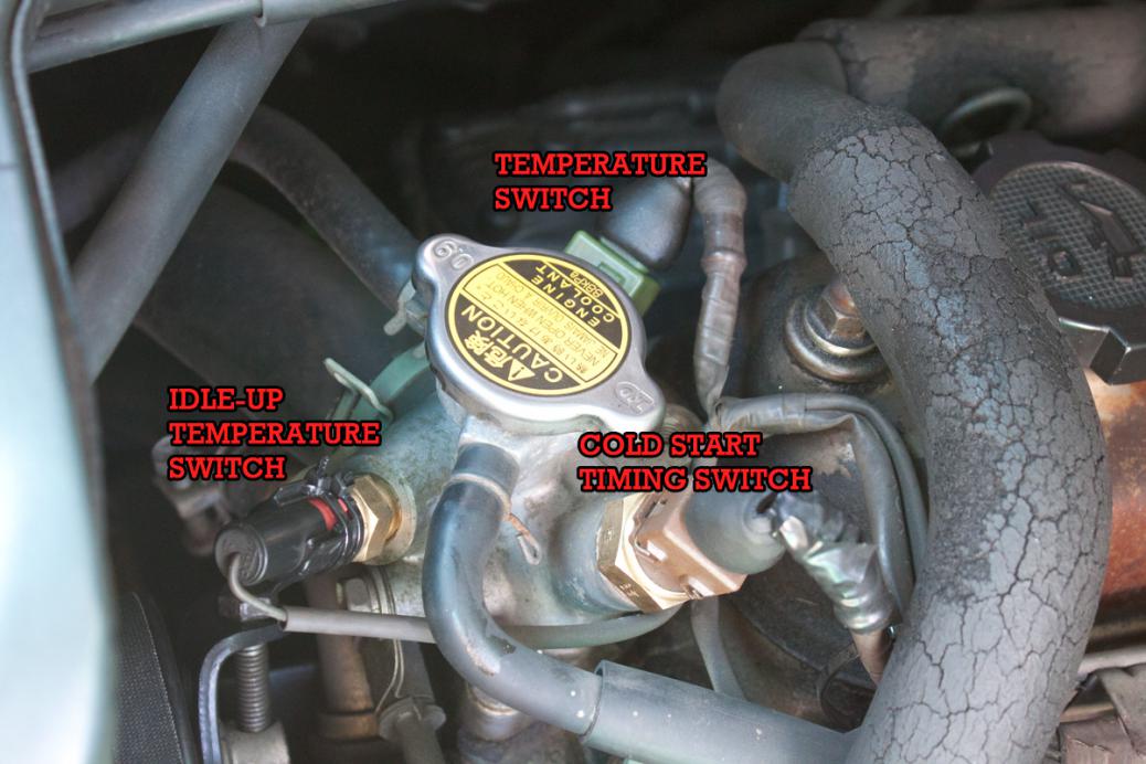

    Idle up temperature switch, and cold start timing switch. Posible temperature switch issue.

    guys sorry for the late response, i've checked the three sensors on the rad, following the steps on the manaul, they are in good condition. what could else be the problem? as of now, the rough idling is still there though sometimes its fine. any more ideas what to other things to be checked? i'm really having a hard time making time for my van because i'm busy preparing for my wedding, we also plan to make van our wedding car.... thanks a lot guys... hoping for your help
