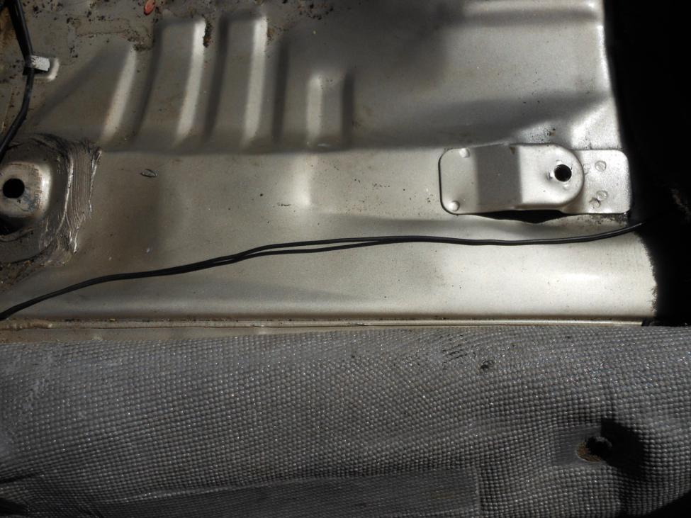

When I've taken my seat out I have a wire that I'm not sure what it is, any idea?

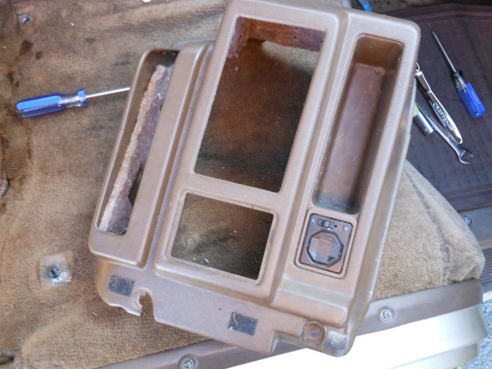

I've taken the console box out of mine. I could use another;
Attachment 609
Any ideas on finding another, other than junkyard?

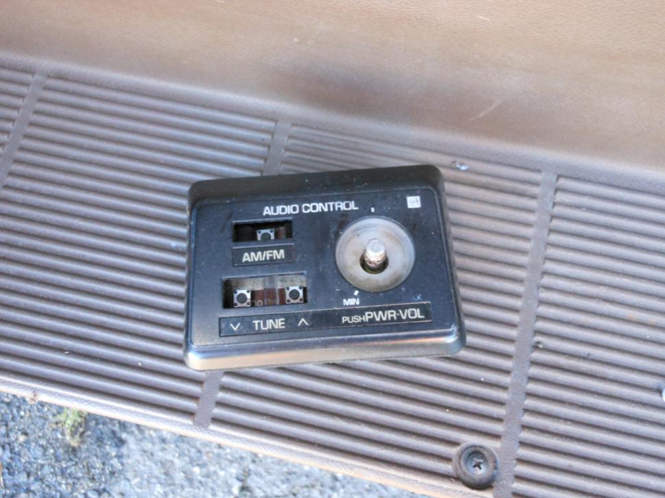

Also need to replace this part,
Attachment 611
For now I'm just gluing as best I could.
Give your kudos to Gwen (llamavan) as she's the one who made this awesome write-up :yes:. The wire in your picture is not stock. That's something that was added........you'll have to chase it down to see where it goes. As for the parts you're looking for, I think the salvage yard is your best bet. Tim
