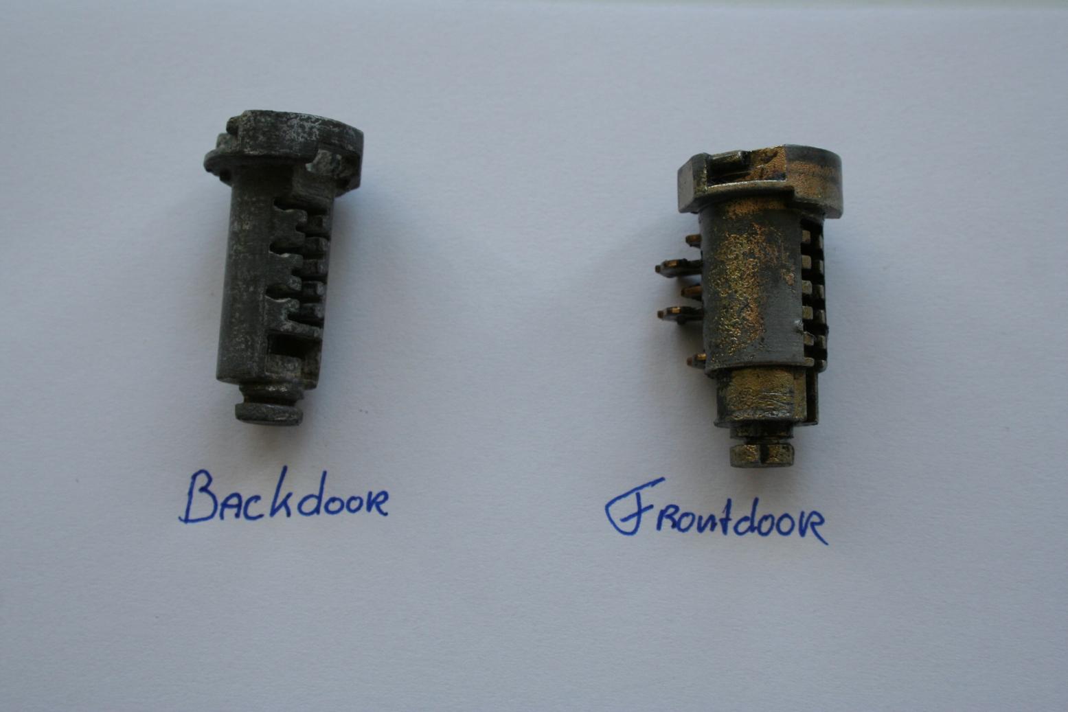

Attachment 6947This is the rear door lock cylinder as it came out of my '86 californian van LE.
Attachment 6948On the left the back-door lock cylinder and on the right a front door lock cylinder. You see the difference, they are also not interchangeable.
Attachment 6949Than i took the backdoor lock of my European Van (Model-F), also 1986. The complete locks are interchangeable, but not the cylinders
greetings JP

I correct my earlier statement. The rear lock core is different. Mine looked like the photo above. Its exposed to the elements and gets clogged up extremely easy. I was able to have the locksmith clean it up and recore it along with my others so it was working again (until I went on a really dusty road - now its clogged again lol)

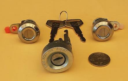

I bought a complete set of new lock cylinders with keys and ignition cylinder, on eBay, similar to this pic. I think it came from Australia. Dude has an eBay store with a selection of the things, which seem either Malaysian or Chinese. They were a direct fit, but I had to swap the little metal 'flag' tab on some of them. Presumably Toyota used them for various model vans and trucks.

They sell lock cylinder's for our vans on Amazon.
https://www.amazon.com/PT-Auto-Wareh...=lock+cylinder
They were used on several models... trucks, corollas and so on.
I haven't seen any combo sets, but it's a simple job for any decent locksmith to match the cylinder's and an ignition.
