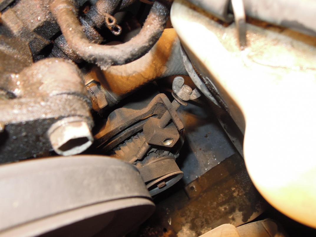

Started getting a loud squeaking noise and found the tension belt tightening bolt that should be connected to the alternator just hanging there:
Attachment 7197
What kind of bolt is used to hold this on to the alternator? It looks like the bolt broke off, as it is still stuck in the alternator bracket. Is the alternator bracket threaded for a bolt, or is it just a bolt going all the way through to a nut? Any ideas on how to fix this stuck bolt in the alternator?

the hole in the alt is threaded it would be best to take it off it should be very tight if it was put in right maybe get out with plyer try to loosen rest of bracket be four taking off. good luck.:clap:

That bolt should have a lock-washer on it. The bolt should spin freely until it contacts the pump bracket, then it gets torqued to 29 ft lbs. Once torqued the bracket should not move freely. It can be moved for alignment reasons (as you have the leverage to so), but you should avoid moving it more than necessary. Once the alternator is mounted it's not a bad idea to retorque.
Your suspicions are correct (that bolt is not the right one (too long), missing the washer, or perhaps the threads on the block are messed up with crud/whatever). This is an important bolt as it applies pressure to seal a major coolant port. This is the port that passes through the block, through the timing cover, and into the water pump area. If the bolt fails to apply the required pressure you could be asking for a blown gasket between the block and the timing cover (not a fun one to replace). To get an idea of how things go together here,
