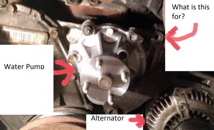

I recently replaced my van's thermostat and waterpump, and am in the process of re-assembling the van.
After I put on the water pump and attached the adjusting bar, I noticed that there was a hole that I did not have a bolt for, and that I do not remember removing a bolt from. I was wondering if you all could take a look at this and see what you thought it was for, as I am stumped on this.
Here is what I'm looking at:
https://imgur.com/a/oCY98https://imgur.com/a/oCY98Attachment 6434
The hole is on the part where the thermostat housing connects.
Thanks for your help!

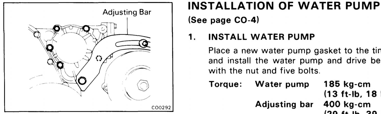

Looking at the diagrams in the manual, it doesn't seem like there is any apparent reason that hole is there. It doesn't attach to anything in particular in these images:
Attachment 6435
Re: Missing Bolt/Hole with no apparent purpose
Mine's empty too, don't sweat it. (Although i'm just putting my engine back in so who knows, maybe I missed something, haha).
I run into stuff like that a lot, but remember not only were there so many different iterations of this engine that might have used that bore, but also individual parts might have been originally made for completely different engines/vehicles.
Kyle
Good to know mine's not the only one that's empty!
And that makes sense. Mine's an 87, so I suppose they could have made some changes and not gotten rid of that bore.
