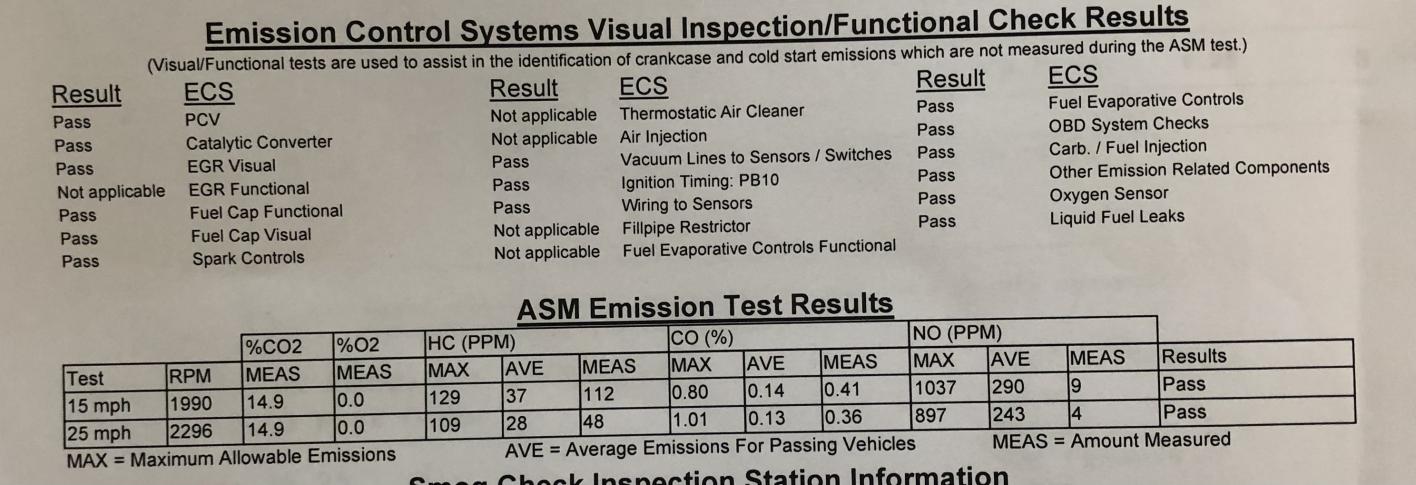

I eventually past CA Smog and thought it would nice to share the progression of emissions improvements as parts were repaired/replaced. While not all variables are held constant, I think it provides useful information those that are trying to diagnose emissions problems
Note that the ignition timing was to spec for all tests.
This test shows what CA smog emissions look like with an egr that is not functioning, a failed catalytic converter, old PCV Valve and 02 senors.
Attachment 12084
Here are the results with the EGR repaired and functioning as the only change from previous test.
Attachment 12085
Here are the results with a the EGR repaired and functioning, catalytic converter replaced with a CA cat, new PCV, new O2 senors (up/down stream)
Attachment 12086
