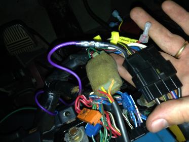

Well it's lunch time, I was checking around "under the hood" and found this:
Attachment 5480
Am I right in assuming these are parts of the water temp sensor? That would make sense because the van did throw a code 22. Anyway, if this is indeed a messed up water temp sensor, would that be able to cause the engine to overheat? I'm curious as to what this water temp sensor does, because apparently theres another sensor of some sort that tells the dial on my dashboard how hot the coolant is. Anyway, please let me know what you think!
Please and thank you!
-Spencer
Re: *(Please Help Me ID This) first drive to work, little bit of a hiccup
Also I'm done with work in about 2 hours and if nobody has any good advice it seems I'll be limping the van home :cry:
Re: first drive to work, little bit of a hiccup
It is not likely this temp sensor caused your over heating. This sensor feeds the ECU with data regarding coolant temp so that the correct fuel mixture is delivered for the given coolant temperature.
I suppose if this sensor also fed data to the ECU to control timing, maybe in a roundabout way if the timing was being too retarded that could cause the overheating but I think likely coincidence.
Seems the easiest thing is get this connection fixed and then see if it does not over heat any more
The effect of having this sensor disconnected besides the obvious check engine light is that when a sensor is disconnected (has an open circuit ) the ECU will default to a rich fuel mixture to keep the engine operating. You would experience poor MPG and possibly smell a strong odor of fuel from the rich mixture, which in turn could damage the catalyst possibly from unburned fuel entering the exhaust.

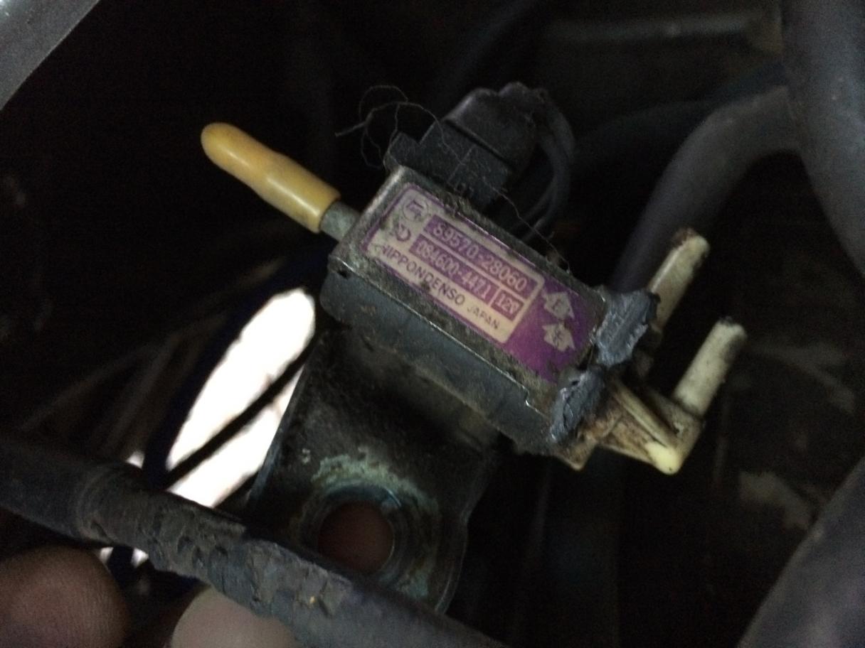

Recently picked up an 89 Auto 4x4, non running.
I replaced the igniter and ignition/distributor coil and started putting the cover back on and noticed a wire that did not have a match. I can't find where the other end gets to. I only have the electrical wiring diagram for 87, and it does not show that particular wiring. I can trace wires from the same position to the TPS and an O2 and I think the oil level sender.
I recall reading that the 89s had a second O2 sensor, could this be for the second O2? Or something else I'm missing?
Attachment 5642
Re: Wire ID?
I would have to look at my other van when I got home to confirm but, I believe that is for the egr temp sensor which is a California emissions only item. My van is not California compliant though my wiring harness does have the mating connector. My engine apparently is so I have the sensor which is installed in the top of the intake right next to the egr valve. I believe if you look in the engine removal section of the factory service manual it mentions disconnecting this(California only) in the section about electrical connections to be disconnected.
Re: Wire ID?
Thanks for the info!
I searched pretty good and did not find the mating connector, so I guess it just isn't there. The manual did outline the part to disconnect in the engine removal section as well.
I left it loose, started it up, drove around, and didn't notice any big issues.

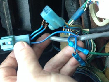

Fuel gauge and sender wire help
Hay Tv family. I noticed the fuel gauge in my 1989 Toyota Van DX 4WD wasn't working so I hoped under to see the connections. Noticed the wires for the fuel sender had been caught up with the drive shaft. I ran to Pick N Pull and found some connectors and swapped it out for my missing ones. I have 2 wires, one brown and one grey that I can't seem to identify. I looked in my repair manual at the wiring diagram but can't seem to figure this out. Could this be for a fuel gauge cutoff switch? Help would be appreciated. Thanks gang.
Re: Fuel gauge and sender wire help
Not sure if this helps but, I noticed in reading the engine wiring diagram, most of the brown wires are for check connector or sensor wires. If anyone can help clear this up, it would be greatly appreciated.
Found a clue to my unsolved mystery. Went to Pick N Pull this past weekend to pick a 1987 4WD TV, noticed the car was originally from California. Looking at the wiring that leads to the fuel sender and fuel pump, there was a connector that was unplugged. Very close to this unplugged connector was the downstream oxygen sensor. If any of you California TV drivers could clear this up for me, it would be greatly appreciated.
88 & 89's (FEDERAL) have a 2nd O2 sensor, it mounts in the rear pipe just behind the flange (ahead of the rear axle)
