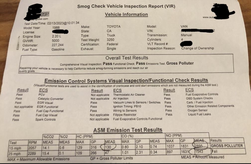

Hello All, I recently moved back to California from Oregon and needed to get my 1988 5spd 4x4 California Emissions Van smoged. It failed:no:. Below are the test results.
Attachment 11963
The way I interpreted the results are it failed the 15 mph test for NO. I was with my kids at the shop and was distracted when the gentleman was explaining the results.

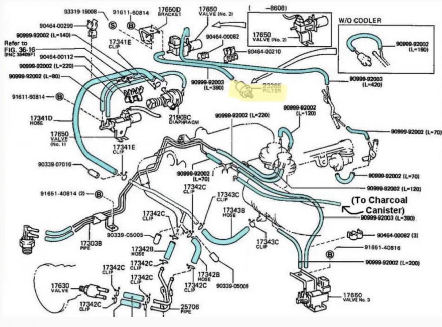

The van runs good (average 21 mpg) but not perfect, it feels like it has a slight miss at idle (~900 rpm). If I try to lower the RPM to 800 with the idle adjust screw it runs rough (shakes). My thought is it has to do with the EGR system by looking at the service manual and way it failed smog and the symptoms it is having. I am trying to diagnose what part needs servicing. Reading the steps to check the EGR system I am a little hung up on the below set.
Attachment 11964
It says to connect the R port directly to the intake manifold with another hose. I am not sure which port to use. I removed and caped the hose that connects the highlighted filter below and attached it there. The engine did not start miss firing. I also used the same port to applying vacuum to EGR Valve in the next step. The engine did not run rough or die. I am doing this wrong? When I apply vacuum to the EGR valve with a large syringe connect to a piece of hose I can hear/feel the valve moving inside.

Your catalytic converter is probably worn out or clogged. I just went through this last year with my van to get it to pass ca smog. All the emissions systems were working as normal but it wouldn't pass smog until I put a new cat on. My van had similar emissions numbers as you did and similar mileage, really high nox and barely too much on the others. Take your cat off and look at the internals look for clogs or damage to the honeycomb structure. If it's the original one it's gonna be real tough to get off so start with some cycles of soaking the bolts with penetrating oil and driving the van around.

Any pointers on what port to run the vacuum lines to apply vacuum to the EGR in the second image of post #95? Thanks!
