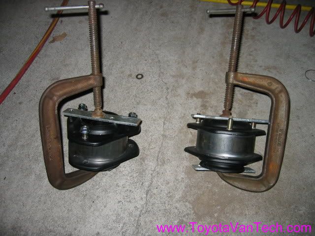

I did some searching for a pre-fabbed lift kit, but could find nothing for the Previa. Since I have some experience as a tool maker and fabricator, I decided to build my own. Since the tire size is limited by the front struts, I decided that 2" would be about right for this project. Here are some pictures and details:
I decided it would be easier to modify existing strut mounts than to build something from scratch, so I went to http://www.rockauto.com and found one their famous "close-out" sales on Previa strut mounts. I ordered 4 of these for only about $20 each. Here's what I got.

The idea is to stack the strut mounts and weld them together. If this is going to work, then this bearing must be removed from the top mount (I'll need enough room to get a socket and extension down in there to install the strut mounting nut). This bearing is pressed in and also has a metal lip crimped in over the edge of it.

Here is my answer to getting rid of that crimped metal that's holding the bearing in place.

Here's what's left after 5 minutes with a die grinder.

Now bearing can be driven out of mount.

Okay, bearing's gone. That's it for the top mount.

Lower mount doesn't need these 3 studs, so using a socket and a vise I press them out.

Okay, that's it for the lower mount.

My van is lifted! My buddy just happened to have one of these, which I borrowed:
Attachment 1085
Made the strut work that much easier and gave me a head start compressing the rear springs before adding these:
Attachment 1086
To install the rear springs.
Still have to take care of a bunch of the other details, especially front end camber looks BAD!!!
But a good days work today!
Front looks a good bit higher than yours Tim, which makes no sense to me. 2" lift in the strut mounts, just like you did them. Used the same srpings on new struts. I'll take a measurement tomorrow.
