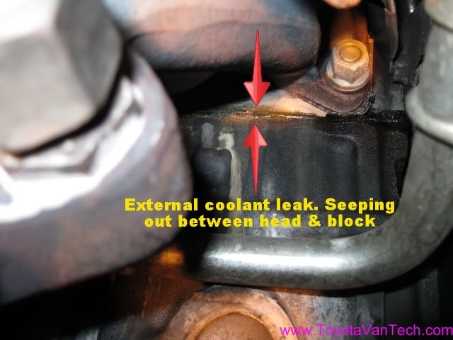

Sometimes the gasket can blow allowing coolant to leak externally. This type of blown gasket simply causes your van to lose coolant and depending on the severity it can still be used like this for extended periods (assuming you keep the coolant levels topped off). I have been experiencing this type of head gasket failure (for over a year now) but the severity of the breach isn't terrible, so I continue to top off the coolant every couple of weeks. I also get to look at a small puddle of coolant on my garage floor every morning when I leave for work (I need to fix this one of these days).
So, to sum things up, your head gasket can fail in any one of these ways or a combination of 2 or more ways at the same time. Based on the fact you are getting coolant in your oil I'd say your problem is the 1st one type outlined. Of course it could also be a crack in your head or block, but by far having the head gasket fail is most common.

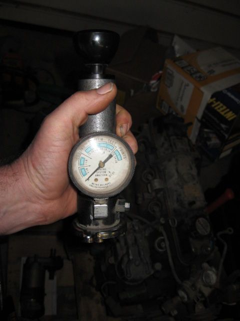

Note: This type of hand pump/testing device is easy to find for purchase but may also be available for renting at a larger auto parts store. If you're thinking of buying, even Amazon has these http://www.amazon.com/Stant-12270-Co...5318080&sr=8-1.
Let the van sit for about 15 minutes while monitoring pressure then begin a careful inspection of the radiator, heater core areas, and any possible place that coolant could be externally leaking. If the van holds pressure for 1/2 hr or more with no detectable leaks, then start the engine and continue your inspection as it's warming up. WARNING: Be very careful of moving parts (like the fan/belts/pulleys) and hot exhaust!. Keep in mind that while the pressure pump is on the van will not automatically vent pressure, so you will need to monitor and manually adjust pressure during the test. All of these testers have a manual pressure relief valve on them so use it as necessary.
I'm guessing you will find it before the van reaches normal operating temperature, but if nothing leaks during this time I might start to suspect a head gasket problem. Note: While checking for leaks be sure to monitor the small 8mm heater hoses by the throttle body and the infamous "hoses of death" outlined in THIS THREAD. Also use a flash-light and a mirror to check the side of the block under the exhaust manifold (see example of leak below).

A couple of tips worth noting. A careful visual inspection can often reveal the source of the leak even when it's not leaking. Keep your eyes peeled for green/greenish blue residue and crystals on or around anything that could be leaking. Your water pump is mounted to the timing cover and coolant can leak from behind the timing cover..........so check there too. Also, our overflow bottles have a level sensor in the bottom and these themselves can leak..........so check around this area too. The rear heater core is right behind the passenger side front tire, so be sure to check that area as well. With the engine off, grab your radiator fan and try to wiggle it back & forth. Sometimes the water pump will wear out and coolant will leak out the shaft. If the shaft is loose (wiggles side to side), then that's a dead give-away. There is a "weep hole" in the bottom front of the water pump housing and sometimes the coolant can drip out here and be slung about by the fan pulley. With the heat of the engine compartment this can cause the coolant to evaporate before it drips to the ground. Happy hunting and keep us posted on what you find. Tim
