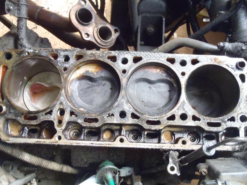

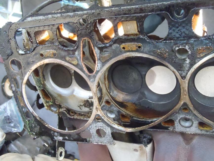

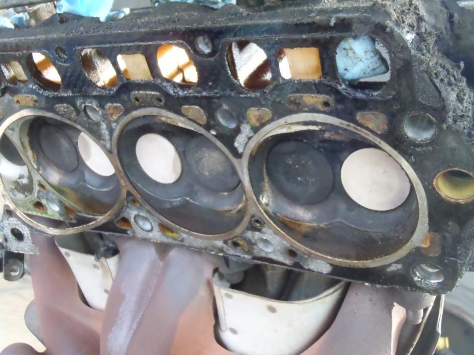

    took me around 7 hrs over 3 days to get the head off. tried my best to label stuff,take pictures and keep noted as I was going along. Most wire connecters fell apart as soon as i started to mess with them. no exhaust studs broke but one is loose. broke the vent hose on the top/back of the valve cover and split a few water and vacuum hoses. all and all not that bad.
    the gasket tore when I was pull the head off so not sure if was already damaged before removing it. obviously cylinder 4 was getting all the coolant. What do you all think from the pics?
    just hope I can get it all back together right once I get it back from the machine shop.

    In your 1st picture, lower left corner, that looks like the spot to me. #4 definitely had a breach as the piston got steam cleaned by hot coolant vapor (this is typically the case with blown head gaskets). Tim

    Love the way a freshly steam cleaned cylinder looks lol. Sorry to hear about the headgasket, but it happens to every van owner at least once in their lives. Whether you fix it or move on is what separates us. Glad you're going to work on it.
