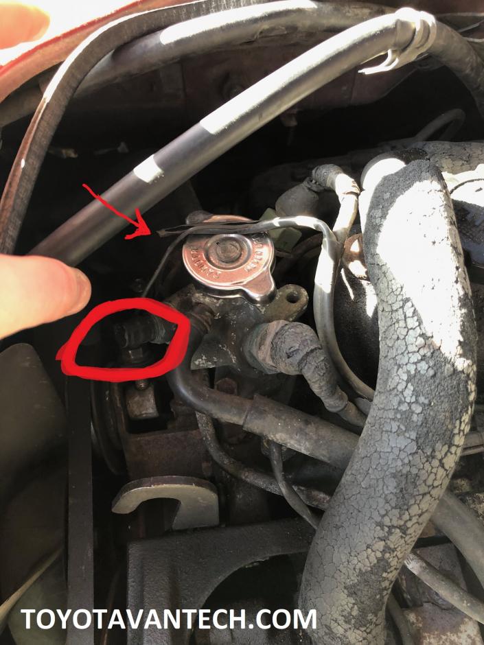

    Soooo, it turned out that there was a cable physically unplugged from the sensor on coolant filler neck:
    Plugging this back in resolved the issue of hard starting, now it starts on the first turn and continues to run! Also, both codes are gone and have been gone for the past 200 miles or so
    The only issue I'm facing at this point is that, after I park it after driving (for long enough to where the van reaches operating temp) and let it sit for a while (10+ minutes), it has issues starting. It struggles in a similar manner as before, just kind of idling weakly unless I floor the gas pedal, after which I hear a whoosh of air and it idles normally.
    Any ideas on what this may be?

    Hello all! Hope you are well.
    After figuring out that the rough start from cold issue was due to one wire being completely disconnected (see below), I have resolved codes 4 and 11 (have driven around 100 miles, codes aren't coming back ).
    Red arrow points to wire that was disconnected. Where the wire connects is circled in red. It's just kind of sitting in there right now. Is there a sensor that's supposed to go there?
    Now I am facing the issue that the van has trouble starting after I have driven it around for a while and then parked it for > 15 minutes. It struggles and idles rough for a minute, then if I take off and give it gas I hear a whooshing sound and the van is back to normal.
    Any ideas what this might be?
    Thanks!

    That picture is of the coolant filler neck by the way, just for reference.
