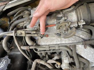

    Hey everyone. I’m new here and this is likely discussed somewhere on this expansive forum. Unfortunately, I’m not sure what this cable is actually for.

    The van wouldn’t turn over after I replaced the battery so I replaced the starter. Now it turns over, but no fire/ignition launch. I’m thinking the fuel pump needs to be replaced because I do not hear any sort of hum from the gas tank when I have the key engaged.
    Anywhoo, can someone tell me what the wire/cable in the picture is? It looks like it’s disconnected from the throttle but I can’t really tell where it’s supposed to be hooked to. Tracing it back it goes down under the shifter area on the drivers side. Any assistance/insight into what this is and what it needs to be hooked to would be much appreciated as I try to get this relic back on the road.

    Looks like cruise control. One that pulls from below is throttle, the top one is transmission kick down.

    Definitely looks like an aftermarket cruise control. I would leave it disconnected. It adds an otherwise unnecessary variable to your troubleshooting. I can't zoom in far enough to see where it hooked to before the pic gets blurry.
