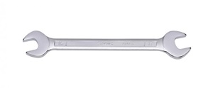

    Hmm I don’t remember having that issue. But then again, i live in a metric country, so I have all kinds of shapes spanners on hand.
    But if you need a flatter one, you can always take an old 19mm or 3/4 inch spanner and adjust it a bit with a grinder.

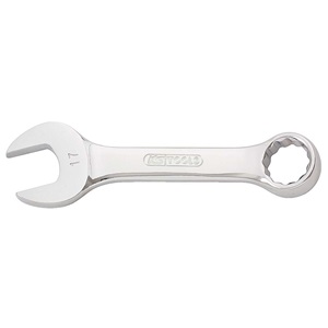

    I've used a thin 17mm meant-for-bicycle-hubs "cone wrench" on brake jobs; there are 19mm ones from companies like Park Tools.

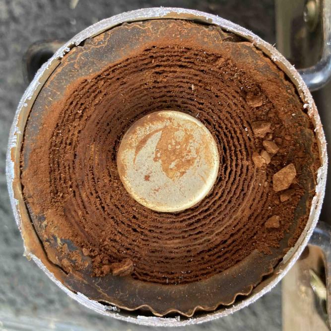

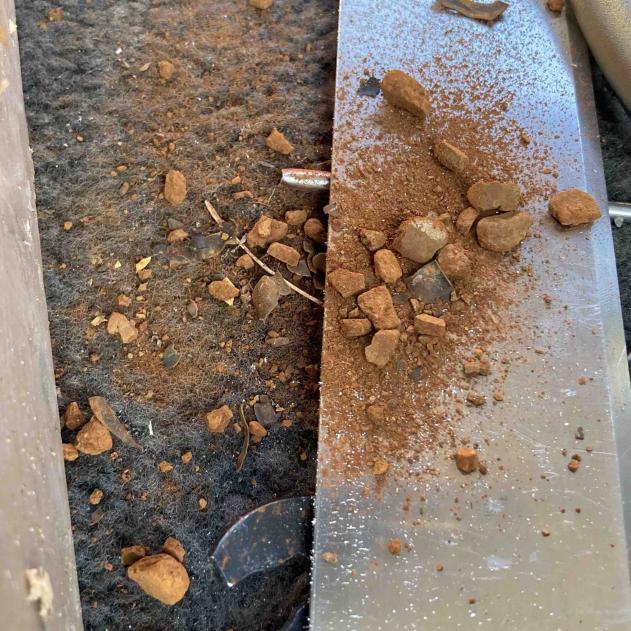

    Check out these rust rocks that formed inside the filter!
    Seems to have made a difference. Thanks everyone
