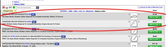

    anyone ever spec out Tim's mega ground wire on Page 3 of this thread?
    He mentioned 2/0 gauge wire - but it would be great to get lengths, lug sizes, bolt sizes to replace rusted or missing ones + I think he did shrink wrap at ends etc.
    OR
    do I just grab the 2 circled items from RockAuto, which will be smaller gauge but save a bit of crimping etc.
    I just started getting the click click issue, and my ground (below) certainly would fall in the suspect category so starting there. Looks like someone did a rebuild and bypassed the whole middle bolt to body.

    Without already having the proper tools to crimp with, sourcing pre-made cables makes sense.
    Most auto parts stores carry pre-made lengths that can be utilized, while they might not be the perfect length, they will ge the job done.
    No doubt those RA cables would work fine
    Pre-made cables will come in standard lengths (12,18,24"....)
    Custom made cables will get you a cleaner install and allow you to spec whatever wire size you want, there's likely an electrical shop near you that would make them up for a small fee. You will need to supply them with lengths, eyelet sizes etc
    Something to consider.
    I have seen cars that had ground wires rust off like yours, more often than not they would come in with the accelerator cable smoking/melted because it was acting as the ground.
    Its worth taking a look at all things that may have been acting as a ground (kickdown, accelerator....) just to make sure nothing else is compromised.

    Either way you will need to take some measurements to get the right sized cables as you will need battery to frame and frame to engine.
    I always add a 2nd ground off the other side (chassis to drivetrain), likely not required but I like a little redundancy, sometimes.
    Given that the positive wire is the same age, might be worth inspecting it while you're in this deep.
